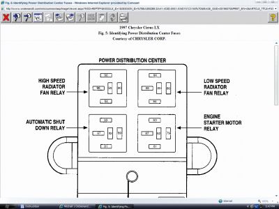

Thermostat has been changed, no leaks, engine overheats only in hot weather and boils out overfill. Mechanic claims it is a relay switch but cant find it. Any suggestions

Are the cooling fan(s) working?

No & the mechanic is saying that it is from a relay switch but he can't find where it is on the vehicle. Said he has looked online etc and now is talking about hot wiring it so the fan runs all the time.

The fans work from the ECT a high and low speed relays, and the PCM, the Power distribution center under the hood next to the air filter box contains the 2 relays, they are side by side on the left end. The ECT is on the thermostat housing.
https://www.2carpros.com/forum/automotive_pictures/62217_Fan_Relays_1.jpg

Just got it back out of the shop. They checked fans, relays, thermostat etc said they found shortage in fuse box--relay and fixed. Left shop car overheated. Radiator took 2 gals of water but over-fill tank was full. Any ideas
