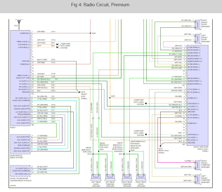

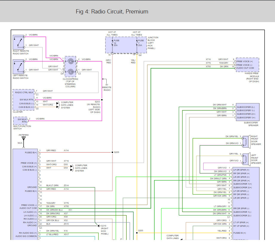

Excellent addition to this thread! Please feel free to help out whenever you are on the site :) I have found the radio wiring diagrams in case anybody needs them.
