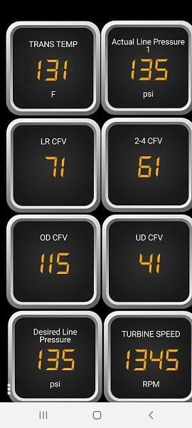

I recently purchased the van listed above (Limited). I have AppCar DiagFCA and used it most recently to check transmission temperature after doing a pan drop, filter and fluid replacement. Yes, haha, I used ATF+4. I owned an older Grand Caravan with the 41TE, so understand the importance of using the correct fluid. I am learning about the 62TE transmission and have delved into the CVI values. All of them, with the exception of L/R, are within the published specs. Specs state 16 - 63 (1/64s Cu. in). I am getting a reading of 68 - 73. I want to know if I have clutch wear. The van shifts absolutely beautifully and suffers none of the known shifting or engagement issues common to the transmission (based on my reading). The only Chrysler transmission that I have seen that uses the term "Preliminary" in the specs for CVIs is the 62TE

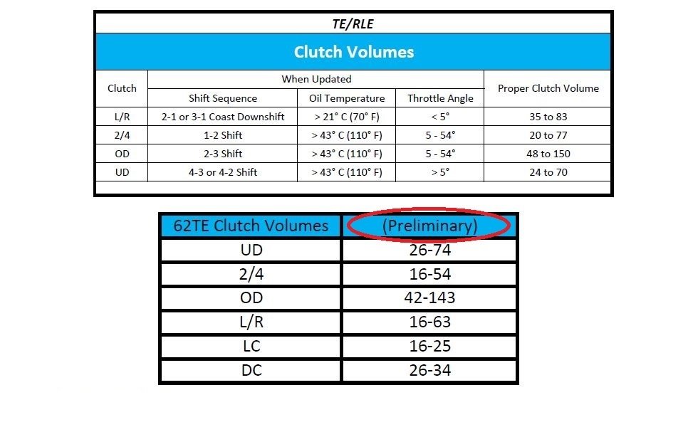

Thanks Joe. Though I'm not sure that's what it means in this case. Please see the attached pic.

That looks like it might be the original factory-programmed values That would be what the computer reverts to after the battery is reconnected, then it relearns the current values within the first two miles or dozen shift cycles. We never called them "preliminary" at any of the Chrysler schools I went to.

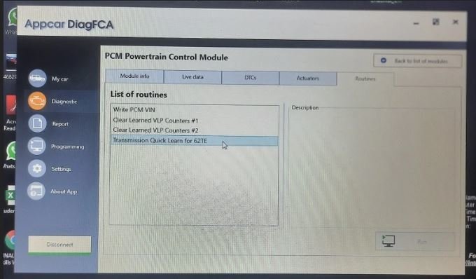

Caradiodoc, now that makes sense to me. When I dropped the pan, I was going to do a relearn via APPCar diagFCA, but the transmission shifted so well that I didn't bother. So, a higher value - or 'out of spec' value - does not necessarily mean excessive clutch pack wear? Here is a pic of the relearn option in AppCar diagFCA. You can see there is also the option to clear Learned Variable Line Pressure Counters. Do you see any benefit in doing this, and/or a relearn if my transmission is working fine? I wonder if there are any benefits to be actualized. Apparently my ECU was reflashed not long before I bought the van, but I'm not sure if the transmission software itself was updated to the latest iteration. Once again, thanks for the information.

The Quick-Learn procedure you have highlighted performs the same relearn as occurs on the test-drive. I don't remember ever seeing this on the earlier DRB2 scanner that worked on up to '95 models. This showed up on the DRB first used on '96 models. The display screen will instruct you to shift into "drive", then press a switch to continue. At that point you'll feel the bumps as it shifts into all of the gears, one after another. It's measuring fluid volumes, then it updates those values in the computer. I've done that a few times, more just for the experience, but the vehicle would still get a proper test-drive to be sure everything was working properly. I was the suspension and alignment specialist, as well as electrical and brakes, but I did replace 13 transmissions in ten years when others were backed up with their jobs. Other than that and routine fluid and filter replacements, I had lots of Chrysler training, but transmissions weren't my specialty.

So to finally address your scanner's relearn procedure, there's no need to do that, and nothing will happen if you do, but what you might find interesting is to write down all the current values, then see if any changed after you do the procedure. I'm going to say you won't notice any difference in shifting quality.
