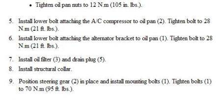

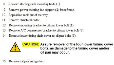

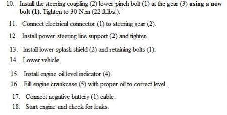

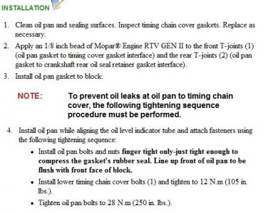

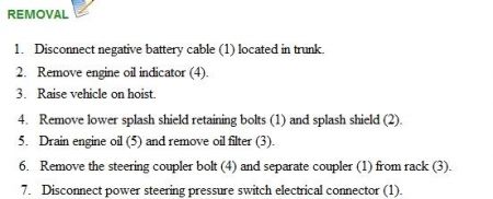

How do you remove the oil pan
Thursday, April 29th, 2010 AT 12:20 PM
BLUELIGHTNIN6
  • 16,542 POSTS
https://www.2carpros.com/forum/automotive_pictures/261618_Noname_2075.jpg
https://www.2carpros.com/forum/automotive_pictures/261618_Noname2_670.jpg
https://www.2carpros.com/forum/automotive_pictures/261618_Noname3_259.jpg
https://www.2carpros.com/forum/automotive_pictures/261618_Noname4_128.jpg
https://www.2carpros.com/forum/automotive_pictures/261618_Noname5_55.jpg
