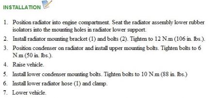

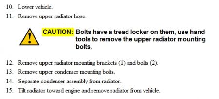

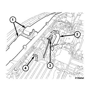

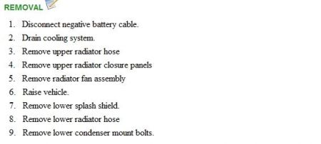

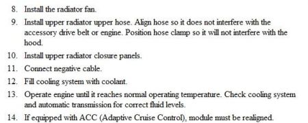

2007 Chrysler 300 how to replace radiator
LARRY FARGIS
MEMBER
2007 CHRYSLER 300
Engine Cooling problem
2007 Chrysler 300 V8 Two Wheel Drive 98000 miles
Friday, May 21st, 2010 AT 6:32 PM
BLUELIGHTNIN6
MECHANIC
16,542 POSTS
+3
Friday, May 21st, 2010 AT 7:19 PM
