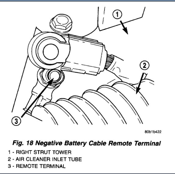

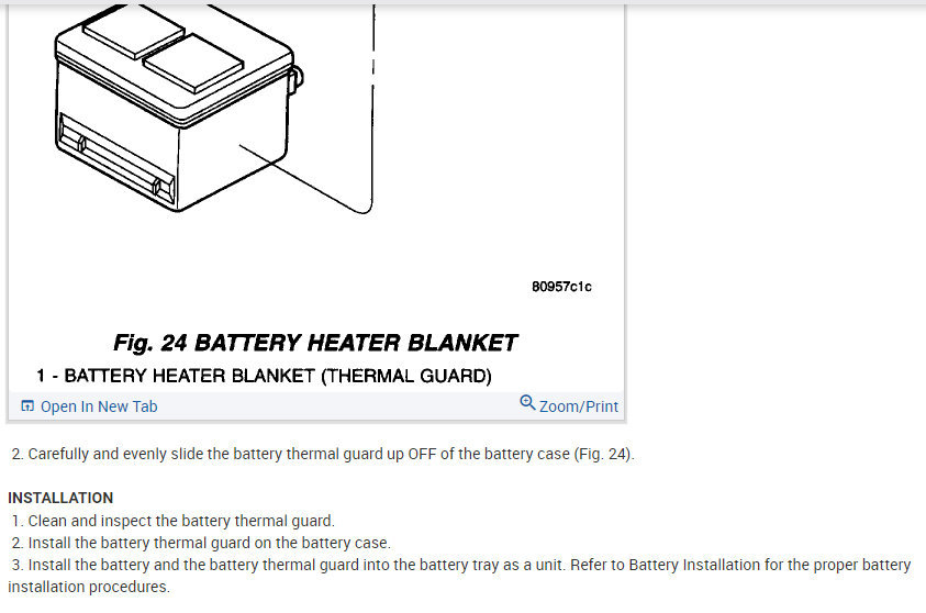

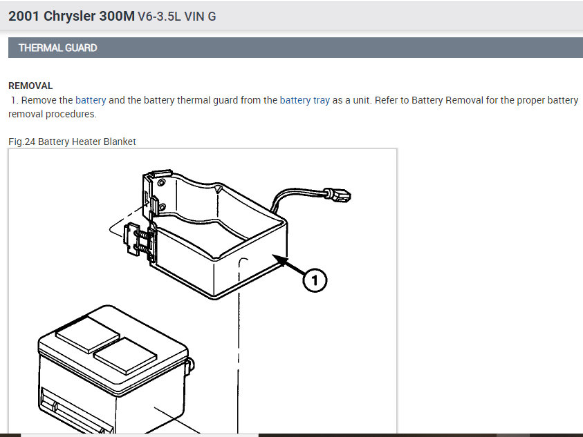

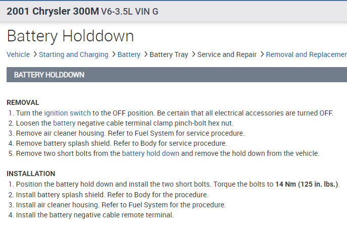

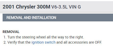

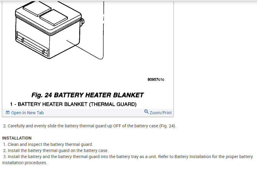

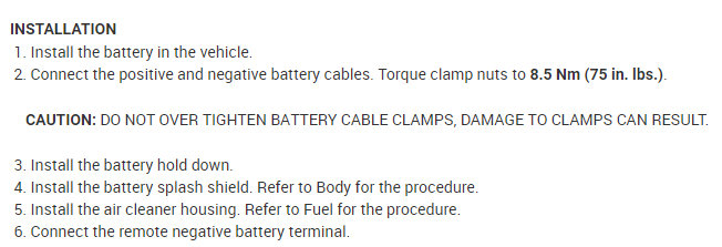

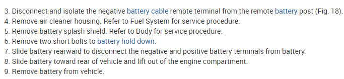

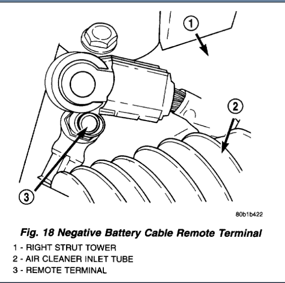

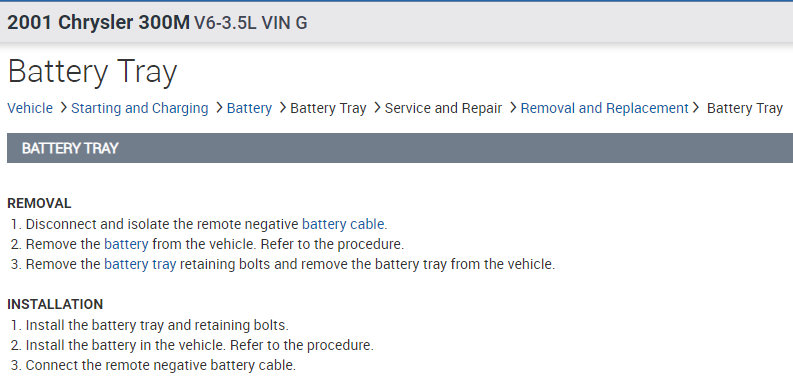

How do I get to the battery to check the connection? The air filter is over it and I can't get it off.
Wednesday, February 25th, 2009 AT 3:49 PM
DANNY L
MECHANIC
5,648 POSTS
Hello, I'm Danny.
Here is a tutorial showing how to remove and replace a battery:
https://www.2carpros.com/articles/how-to-replace-a-car-battery
I've attached picture steps below on how to remove and replace the battery on your car. Hope this helps and thanks for using 2CarPros.
