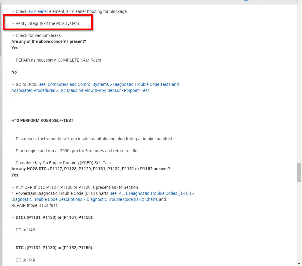

Changed out the purge valve, ran pretty well going home cut it off for a few minutes and went to start it back up and have a rough idle. Once again does anyone have any idea of what may cause this issue. Note: I changed the purge valve to try and stop the rough idle. The only code it has ever thrown is a p1132. I'm thinking maybe just old fuel injectors. They are the originals, also I have changed the upstream 02 sensors.
Apr 30, 2022 at 7:44 PM
  • CAR REPAIR CONTRIBUTOR

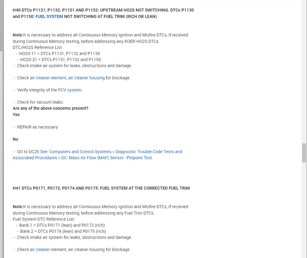

So, this issue can be caused by the PCV, so we need to make sure the valve is seated but the hose doesn't have any cracks in it.
There are a number of ways to check that but the best is to disconnect both ends, plug one of them with a bolt then put vacuum to the other end. The line should hold vacuum immediately. It is doesn't then it is cracked and needs to be replaced.
Then we need to check for vacuum leaks using this guide:
I attached the info for this code so let's run through all this and we can go from there.

So that is odd that it is not there all the time. However, that points to a possible vacuum leak so we need to wait for it to run rough again and then spray down the intake with brake cleaner and see if it smooths out at all.
Normally a vacuum leak is more constant, but anything is possible.

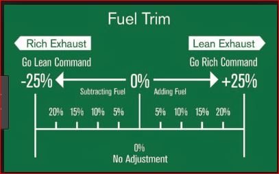

Next, we need to check the o2 sensor data when this is running rough and see if it is rich or lean. I am attaching the chart that will help with telling if it is rich or lean.

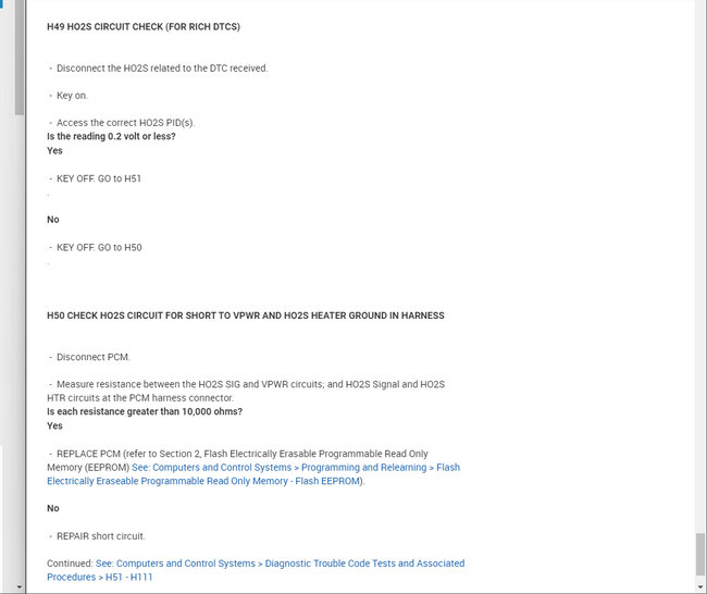

Hello, so this is what I have found out, I thought I had already changed out the driver side upstream sensor, apparently not I found the fuse that controls. The 02 sensors among a few other thing torque Converter solenoid and transmission shift solenoid but once I pulled that fuse running rough it took about 10-15 seconds and the idle leveled right out as soon as I plugged it back in the choppy idle came back, could the driver side upstream sensor be the issue I don't have a code for that sensor. i have a code for p1132, but maybe that sensor is sending a bad signal saying lean and the other sensor is trying to correct for the leanness?
Okay. Yeah, that can absolutely be the issue. However, which fuse were you pulling? I just want to confirm this is an upstream sensor.
What you are doing when you unplug the sensor is causing the PCM to run off of a predetermined set of parameters so that means it doesn't read the o2 sensors anymore because they are disconnected. So, what I would do is go under the truck and unplug the sensors one at a time and wait for it to smooth out. Then replace any that cause it to smooth out.
