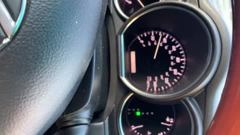

Hello, I bought the vehicle listed above in late March that chirps/squeaks when I step on the gas pedal while in drive, but not in neutral or reverse. When I let go of the gas pedal, it stops. I believe I hear the noise either in the dashboard or in the engine bay. It's especially prevalent when I don't accelerate fast and when I maintain my speed. Additionally, about half the time when I start the engine, I hear a high pitch squeal toward the end as I'm about to release the key. Also, to note, I hear a brief low-pitch rattling/grinding in the dashboard when slowing down to a stop. The rattling/grinding noise in front of the dashboard (?) lasts about 2-3 seconds.

Hi Joe, thanks for responding. Last week I was able to gently tug the serpentine belt from the passenger wheel well. The tension seems fine to me. But later today, hopefully, I can remove the belt (never done anything like this before) and inspect it. Since the noise started after the fluid leak and after the new water pump, radiator, and thermostat were installed, I’m thinking the belt was probably contaminated with coolant. Maybe even any of the pulleys or the engine mount? I read that I can clean the pulleys with a carburetor cleaner.
As for pressing the brake pedal gently when it squeaks/chirps, the noise does not change.
As for the sound changing based on speed, it seems the sound does not change based on speed.

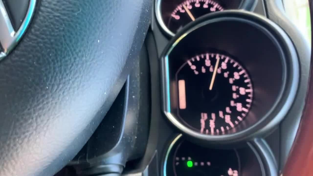

Attached is the video, hope you can hear it. Let me know if you need another video of it. Thanks again!

I did hear it. That sounds like the belt. Inspect it and try cleaning things. I think you are correct about the belt being contaminated.
Let me know what you find or if there is anything I can do to help.
