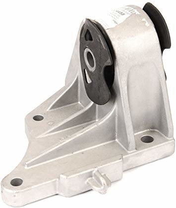

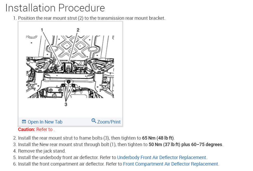

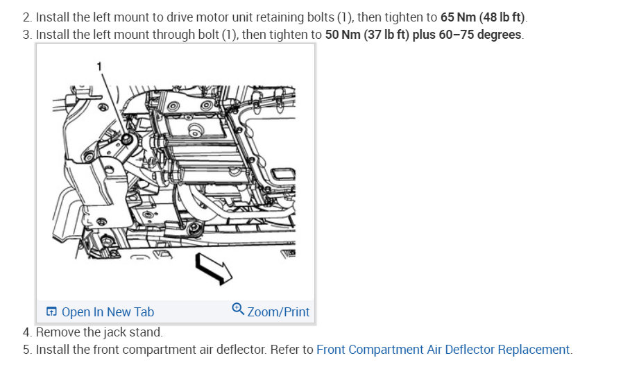

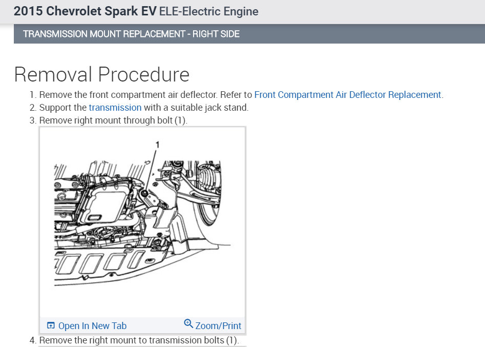

Car listed above EV model. I've got a worn motor mount and I'm looking for torque specs. Repair procedure would be helpful too.
GM 95024458 "Side mount"
Mar 2, 2020 at 2:26 AM
  • CAR REPAIR CONTRIBUTOR
  • 54,436 POSTS

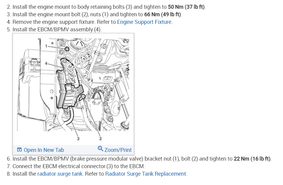

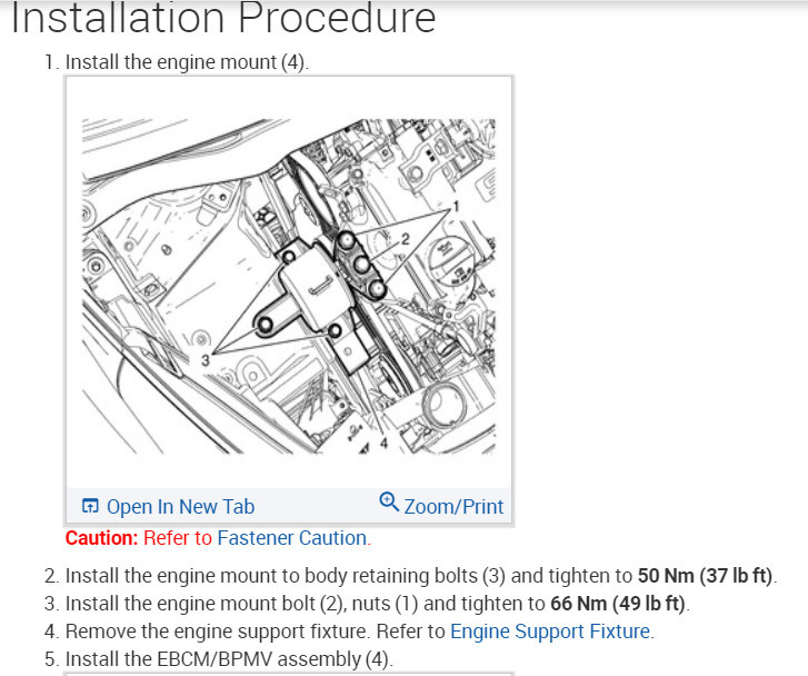

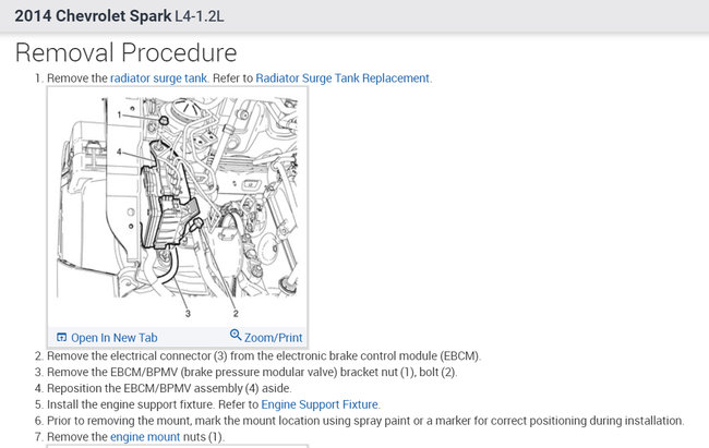

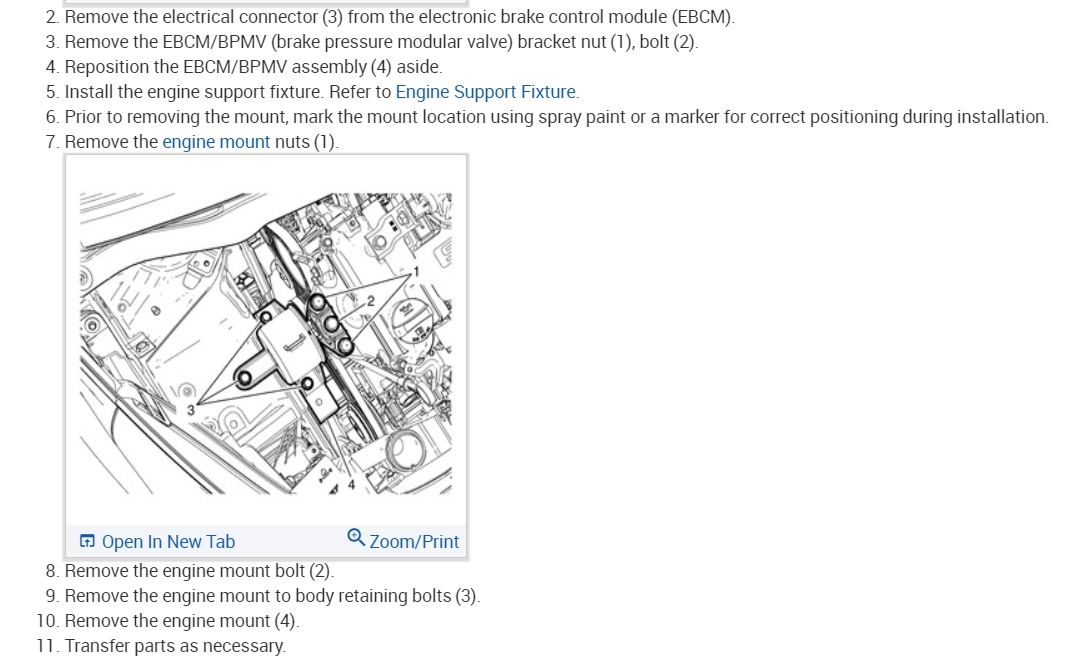

Here are the engine mount installation instruction in the diagrams below. Check out the diagrams (below). Please let us know if you need anything else to get the problem fixed.
Mar 3, 2020 at 10:32 AM

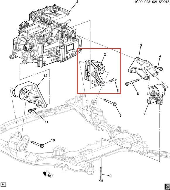

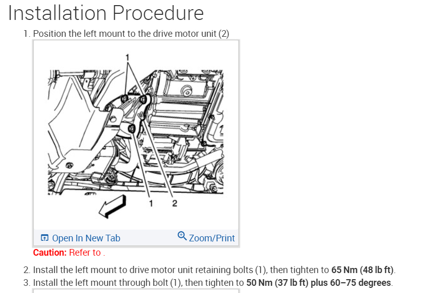

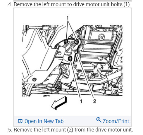

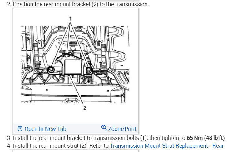

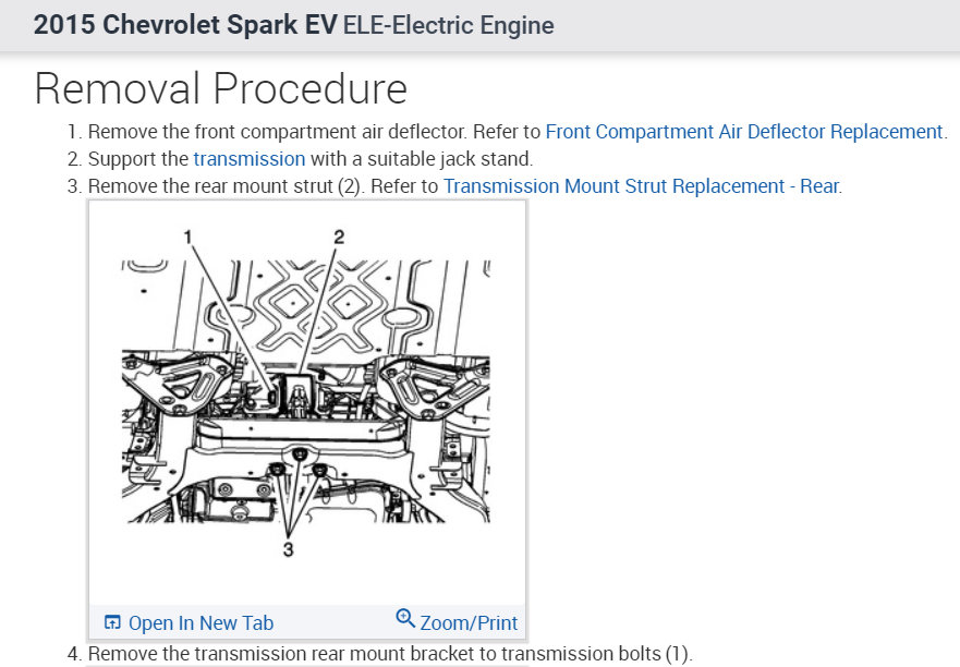

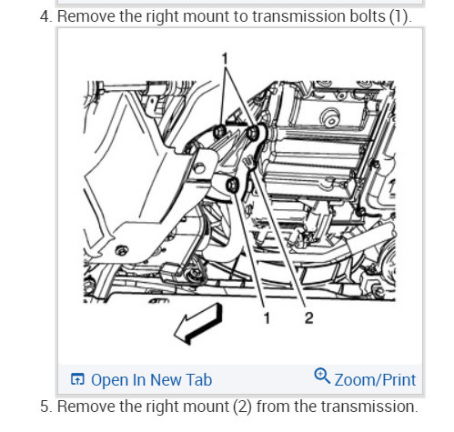

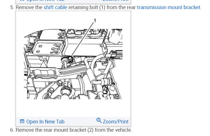

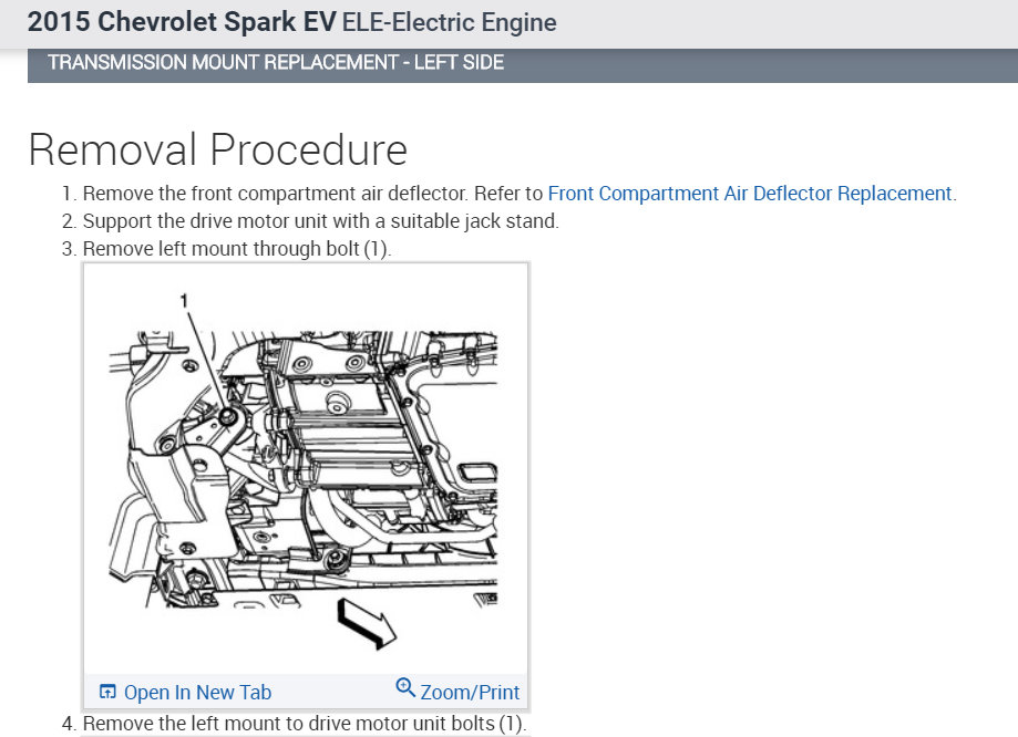

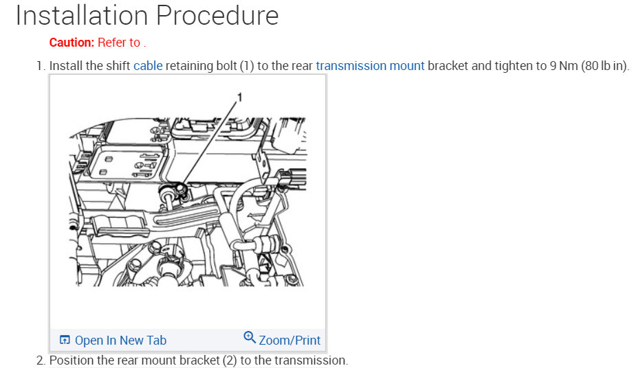

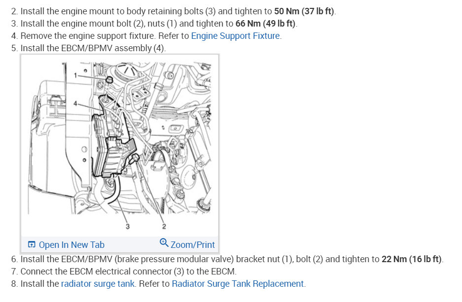

Thanks Ken and Roy. Ken, those diagrams are for the gasoline Spark. I have the EV version, 2014 Spark EV 2LT. I attached a diagram showing the part.
Mar 3, 2020 at 11:58 AM
Hello again.

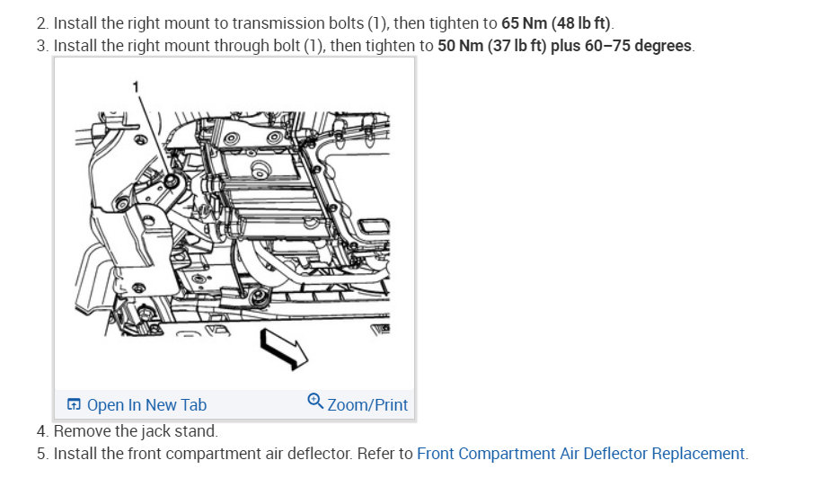

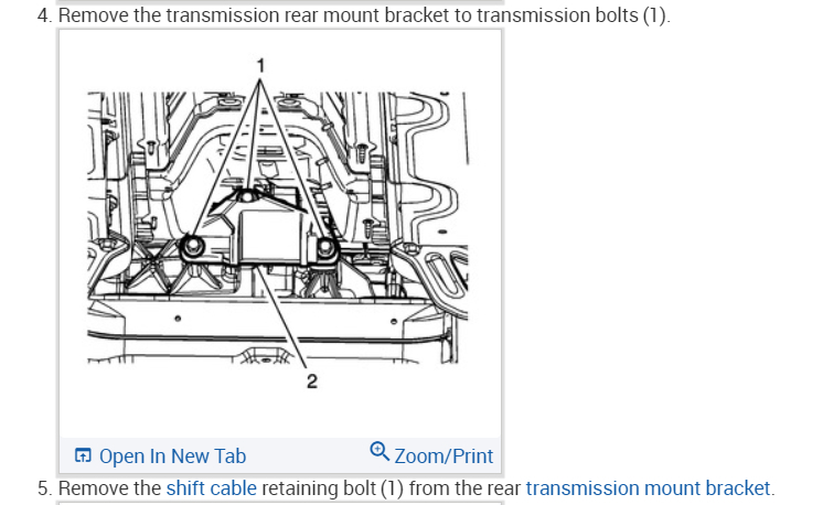

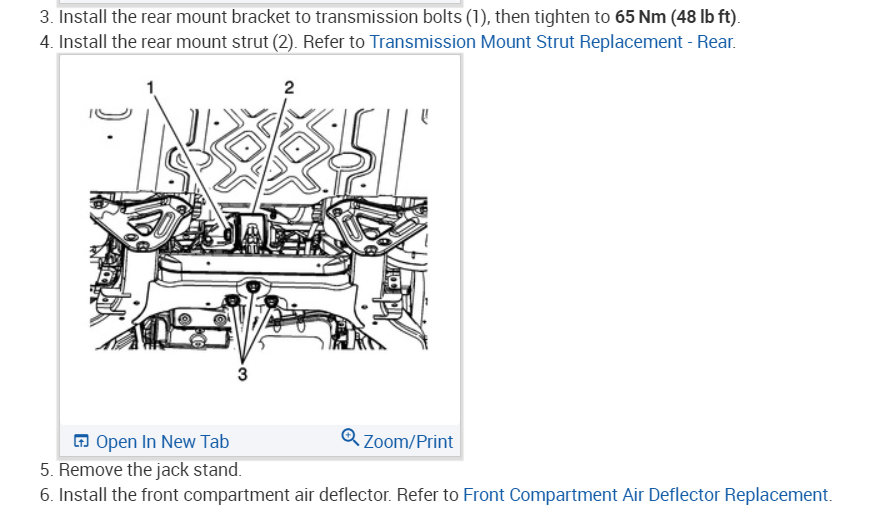

That mount can be accessed by removing the bolt to the frame. Then you will need to jack up the motor with a block of wood and a floor jack and then release the bolts for the mount.
Mar 3, 2020 at 12:37 PM
  • 54,436 POSTS

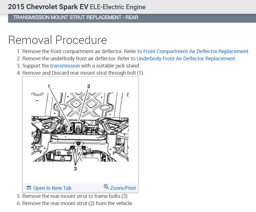

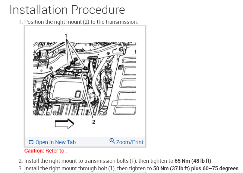

Sorry our bad, here is the motor mount replacement instructions for all of the mounts just in case you need them. Check out the diagrams (below). Please let us know if you need anything else to get the problem fixed.
Mar 4, 2020 at 9:40 AM
