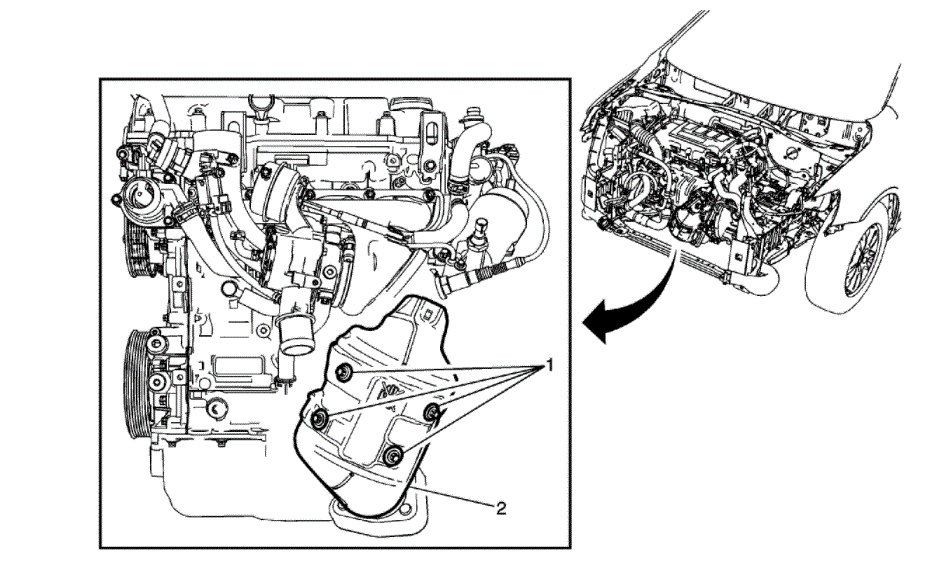

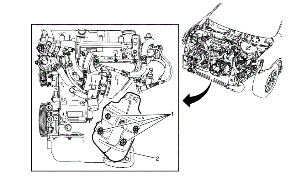

A common issue for noise as you described is the shield around the catalytic converter. It can vibrate causing a rattling noise if that is what it sounds like.
https://www.2carpros.com/articles/how-exhaust-systems-work
I would check that shield and see if it is loose. Take a small hammer a tap it and see if it creates the noise.
I attached a picture of the shield and its location.

Hello, thanks a lot for your reply. I tried looking into that however the heat shield noise seems to be an issue that would be heard even when hitting the pedal while idling. the interesting part is that I don’t actually face this issue when idling it only happens when accelerating forward on low rpm's or when going in reverse. I think the clearest time the noise could be heard in the video is on around the 14th second in the video (00:14). I appreciate your response whatsoever, if you have any idea or additional suggestions please let me know, thanks!
Oct 8, 2020 at 4:29 AM
The shield is common for accelerating and letting off the gas as well.
I would still check the shield to be sure it is not the issue.
