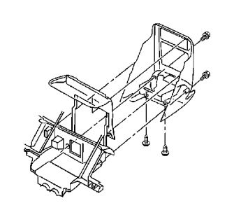

I have a 6-disc cd changer and two discs were inserted at the same time. They cannot be seen at the insertion slot so they cannot be removed from the front. How do you remove the trim so that you can get at the radio and cd changer?

Open the ashtray or the cupholder. Remove the following sets of screws: Two screws from the front of the trim panel. For access to the front screws, remove the ashtray or the cupholder. Two screws from the bottom of the trim panel. For access to the bottom screws, remove the console storage box. Use a small, flat-bladed tool in order to remove the upper tabs on the IP accessory trim plate from the instrument panel. Disconnect the electrical connectors, if equipped. Remove the IP accessory trim plate from the instrument panel. Installation Procedure Install the IP accessory trim plate to the instrument panel. Connect the electrical connectors, if equipped. Align the upper tabs of the IP accessory trim plate to the instrument panel. Install the following sets of screws: Two screws to the front of the trim panel Two screws to the bottom of the trim panel Notice: Refer to Fastener Notice in Cautions and Notices. Tighten all of the screws. Tighten the screws to 2 N.m (18 lb in). Install the console storage box, if required. Install the ashtray or the cupholder, if required. Close the ashtray or the cupholder.
https://images.2carpros.com/forum/automotive_pictures/147643_console_1.jpg
this should be what you need,post back with any other questions.
