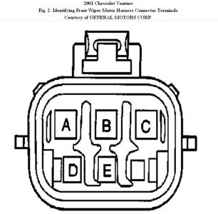

Hi I have some small Problems with this Vehicle.
No Cold AC
Passenger Power Window
Windshield Wiper Motor
With the Passenger Side Power Window..
It will go down but not up..
I placed a Multimeter onto the Motor Wires and get 12-14v on the down on both Switches but anywhere between 0 and 4v on the UP with both switches..
My question what switch do you think needs replacing the Passenger is my Guess but as these switches are interconnected what would be your guess?
My Wiper motor only works on High Speed although I do hear a Click if I rotate the slow speed switch coming from the motor area with the hood up.
Would you say that would be a Motor Issue ?..
Rob..

https://images.2carpros.com/forum/automotive_pictures/192750_Wiper01VentureFig02_1.jpg

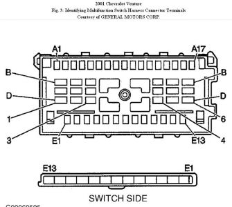

https://images.2carpros.com/forum/automotive_pictures/192750_Wiper01VentureFig03_1.jpg
6.Measure resistance between multifunction switch pigtail harness connector C201 terminals E3 (Dark Green wire) and E9 (Yellow wire) - (component side). See Fig. 3 . Turn wiper portion of multifunction switch to MIST, LO and HI positions. If resistance is less than 2 ohms, go to next step. If resistance is 2 ohms or more, go to step 10 . 7.Measure resistance between multifunction switch pigtail harness connector C201 terminals E3 (Dark Green wire) and E9 (Yellow wire) - (component side). Turn multifunction switch through all DELAY positions. Resistance should be 39-680 k/ohms. If resistance is as specified, go to next step. If resistance is not as specified, go to step 10 . 8.Measure resistance between multifunction switch pigtail harness connector C201 terminals E3 (Dark Green wire) and E9 (Yellow wire) - (component side). Turn wiper portion of multifunction switch to MIST, LO and HI positions. Resistance should be 24 k/ohms. If resistance is as specified, go to next step. If resistance is not as specified, go to step 10 . 9.Connect multifunction switch harness connector C201. Connect front wiper/washer motor harness connector. Turn ignition switch to RUN position. Turn wiper portion of multifunction switch to HI position. If front wipers operate normally, go to step 11 . If front wipers do not operate normally, go to step 12 . 10.Replace multifunction switch. After repair, go to step 13 . 11.Replace front wiper drive system module. After repair, go to step 13 . 12.Replace front wiper motor. After repair, go to next step. 13.Operate system to verify repair. If problem does not exist, system is okay. If problem still exists, go to step 3 . As to the A/C not cold, get the low and high pressure readings and let me know what they are. Did you check if the compressor is engaging?
