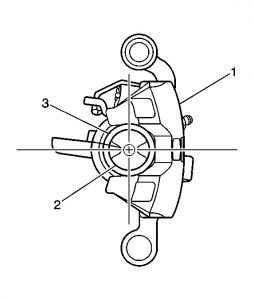

How do you get the calipers to rest on the rear brakes after I have replaced the brakes on it? What is the special tool that is needed to get the caliper back in place?

Yes tool needed most parts houses carry fits into notches on piston then you turn while pushing in to retract piston
