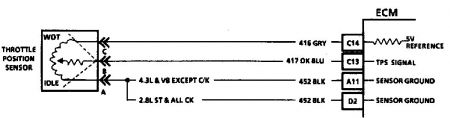

Yes, I have actually changed the U-Joints and I do have a 1 piece drive shaft. This w/e my truck died at a red light. It would crank and turn, but not start. I put a new coil and Control Module (Distributor) in and it began working. When the truck died; however a trouble code for a TPS Sensor came up. The truck is actually riding smootherl, but the shakiness has continued.
The shaking happens occasionally while idoling and at a steady ride, but consistantly when speeding up slowly at speeds above 45. It does happen at speeds below 45, but only occasionally. Now, accompanying the shaking is a hesitating or lurching when taking off. I seem to also have a huge loss of power at the top of my gears.. (I.E on interstate when speeding up it will not "kick into high gear". Seems to stay in the same gear giving me no power) but, again, NO REV? (Doesnt feel like the transmission is slipping, but does feel as though it is not changing gears correctly)
I am thinking Torque Converter? Would this fit the bill?

It may lead to the converter or the TCC or more. With the tps code, you have to go after this first and is likley related.
This is the circuit:
https://www.2carpros.com/forum/automotive_pictures/30961_tps_1.jpg
The TPS is NOT adjustable on this one. The voltage should be 1.25-5.0.
Install jumper wires to enable a connection of a DVOM in paralel between TPS harness connectors. Connect DVOM positive lead to Dark Blue wire Terminal. Connect negative lead to Black wire termnal.
Turn the ignition on, engine off. Signal voltage should gradually change form less than one volt at closed throttle to about 5.0 volts and wide open throttle position.

Okay I will do that. The trouble code went out after I had the coil and Control Module replaced.I am waiting on the drive cycle to complete (not sure of the cycle on this truck) before checking again. If so I believe this to be a seperate problem as theTHE ENGINE RUNS PERFECT, EVEN WHEN THE SHAKING IS HAPPENING. I have little problems in the first 2 or 3 gears. It is the interstate and above 50 that gives me fits.
