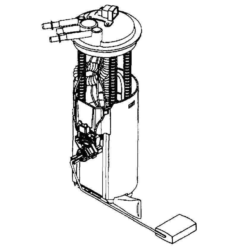

My blazer is stalling when I push the gas pedal down to far.I can only give it a lil gas at a time. When it stalls I can only start it when I go under the car and bang the fuel tank then it stated leaking I need a new tank can you help me?
Thursday, September 21st, 2006 AT 8:45 PM
17 Replies
DIGUGLIELMO
  • 28 POSTS

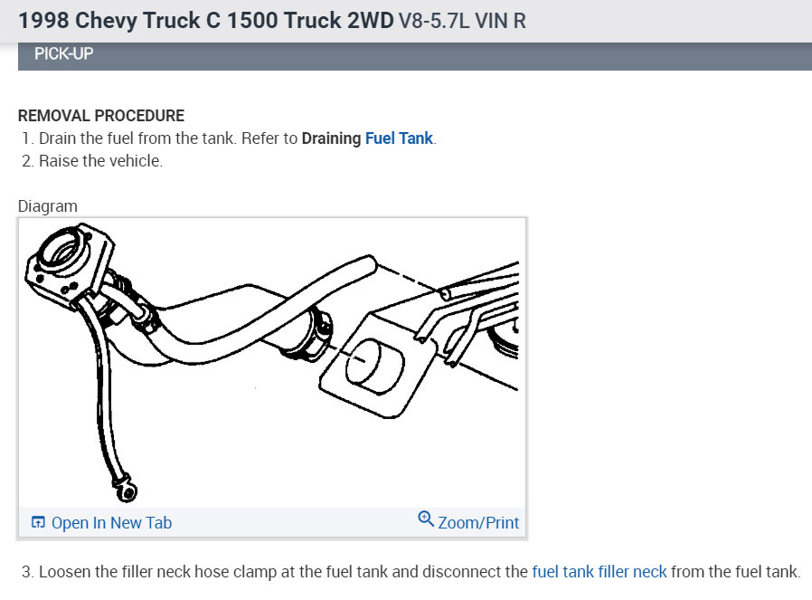

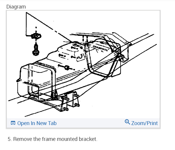

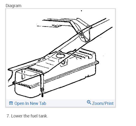

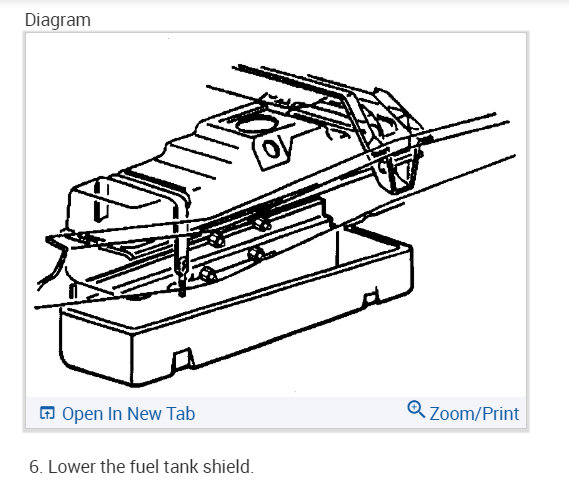

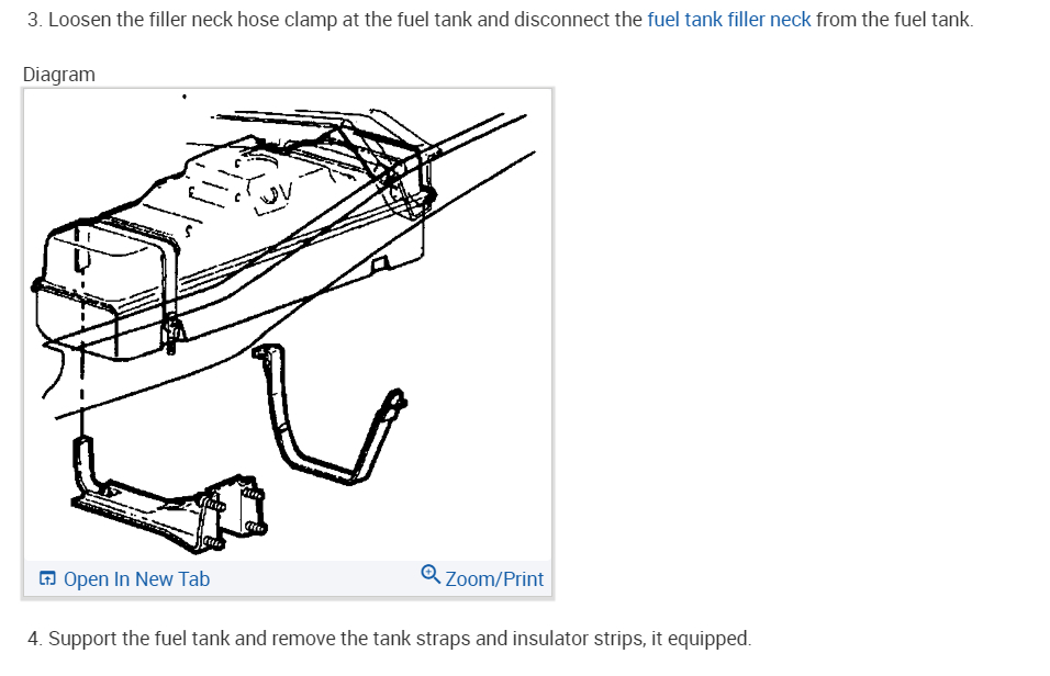

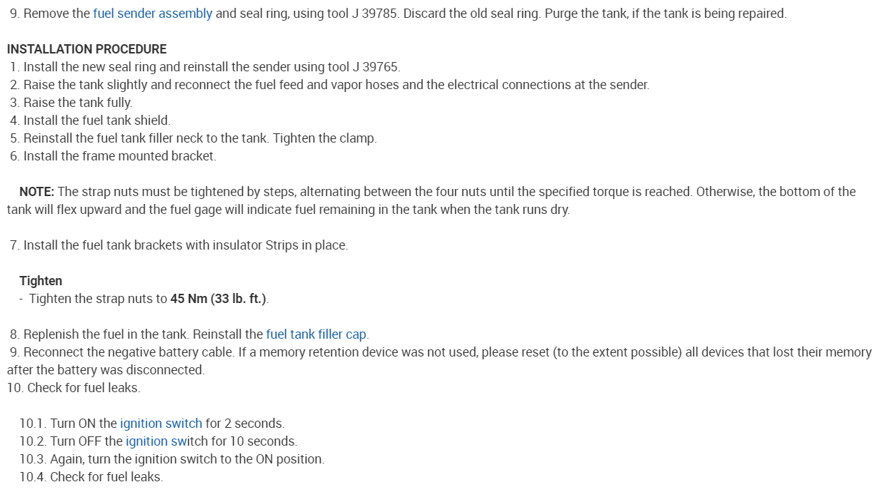

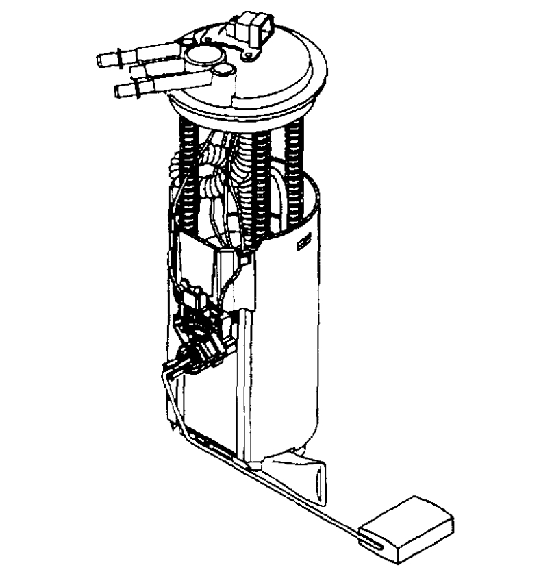

Sounds to me like your fuel pump is losing back pressure and stalling itself out due to loss of fuel, check the fuel filter first, then replace the fuel pump. If that doesn't work go get your injectors cleaned. Here is how to change the tank out in the diagrams below. Check out the diagrams (Below). Please let us know if you need anything else to get the problem fixed.

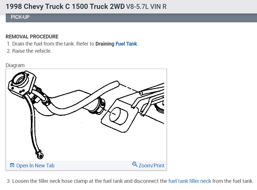

Why would there be a green ball in the fuel tank?
Thursday, September 24th, 2020 AT 11:27 AM (Merged)
D6SPAN
  • 58 POSTS
The green ball is to prevent fuel from exiting the filler neck while cornering and filling the tank. It should be held in place by a plastic cage in the bottom of the neck. It is possible a thief tried to siphon gas and damaged it.

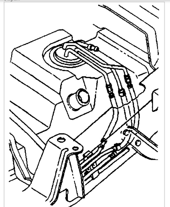

I am putting a new gas tank on my truck when I took the old one off I found that one of the of four of the lines from the sending unit was not and had not been hooked up. Infact it was toatly gone at the front of the truck. The truck ran fine but the tank leaked. It is the smallest of the four, and does not thread on the hose clamps on. My question is what is that line for, and can I get by without it?

It is most likely an emissions line for the EVAP system. It is not a good idea to go without it as contaminants will get sucked into the fuel system and cause a lot of problems. Replace the line as soon as you can.
