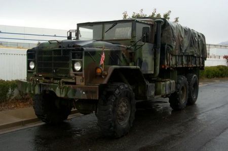

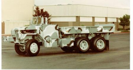

You can try checking your glow plugs, the gasoline like ether may have burned them out when they were trying to start it with gasoline in the lines. Actually gasoline will run in a diesel, my old army truck with a multi-fuel. And I could run either gas or diesel.
https://www.2carpros.com/forum/automotive_pictures/307270_Army_truck_2_1.jpg
But we did not have all the complicated filters as today that recognizes gasoline as water. My newer army truck will only run on diesel.
https://www.2carpros.com/forum/automotive_pictures/307270_Army_Truck_2.jpg
