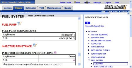

Recheck the fuel pressure, test the coolant temperature sensor, fuel pump relay and idle air control valve.
https://www.2carpros.com/forum/automotive_pictures/12900_fuel_pressure_8.jpg

55psi is low -under acceleration the pressure should increase 8-10psi
