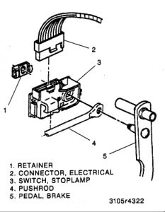

how to do, and how much time?

R/R 30 mins of labor
https://images.2carpros.com/forum/automotive_pictures/12900_brake_16.jpg
Remove or Disconnect Negative battery cable. Retainer from brake pedal pin. Switch by unsnapping from pushrod. Electrical connector from switch. Install or Connect Electrical connector into switch. Switch by snapping it onto pushrod. Retainer onto brake pedal pin. 4 Negative battery cable
