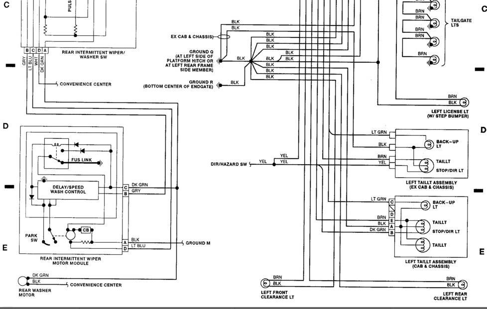

brake lights will not work?
1994 CHEVROLET TRUCK
JOHN---G
Left rear blinker/brake light wont work. new bulb did not work, another new bulb did not work. switched rear bulbs - left wont light right still works. all other blinkers work. Meter on left rear socket shows about 11volts, same on right. Meter shows pulses of blinker on both sides. Put red probe of meter on contact inside socket and touched outside socket or inside and it reads about 11 volts. Put wires of new socket on contact inside socket and ground and would not light on left but same procedure works on right. crimped socket a little to hold bulb tight - no go. Strange problem --- what do you think?
Jun 16, 2009 at 7:24 PM
DR LOOT
  • CAR REPAIR CONTRIBUTOR
  • 2,311 POSTS
if you have replaced the light socket and it is still the same that's not the problem, the problem is probably in the wiring coming out or going to your trailer light socket on the bumper. This guide will help us fix the problem

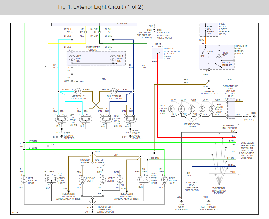

https://www.2carpros.com/articles/brake-lights-not-working
Here are the brake light and blinker wiring diagrams so you can see how the system works. Check out the diagrams (Below). Please let us know what you find. We are interested to see what it is.

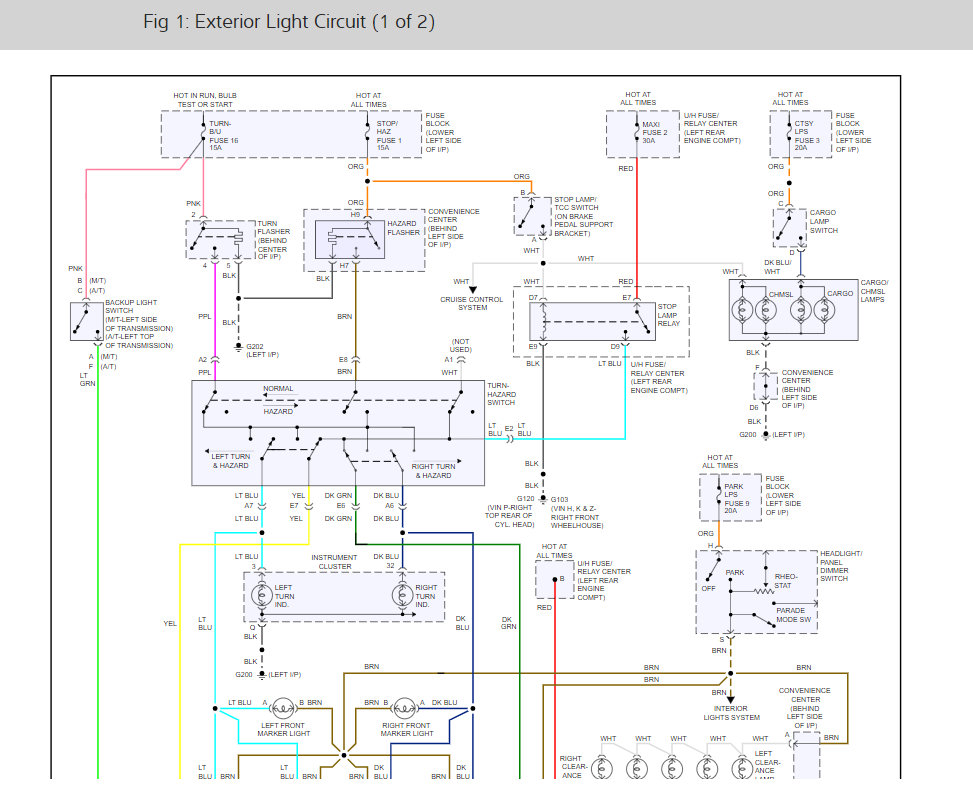

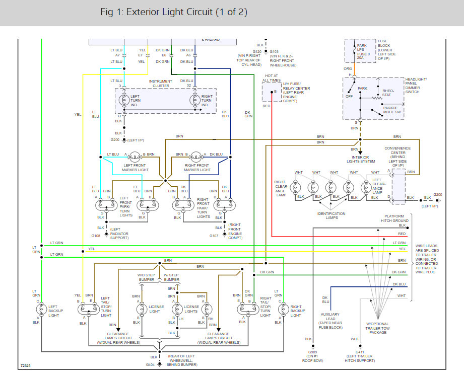

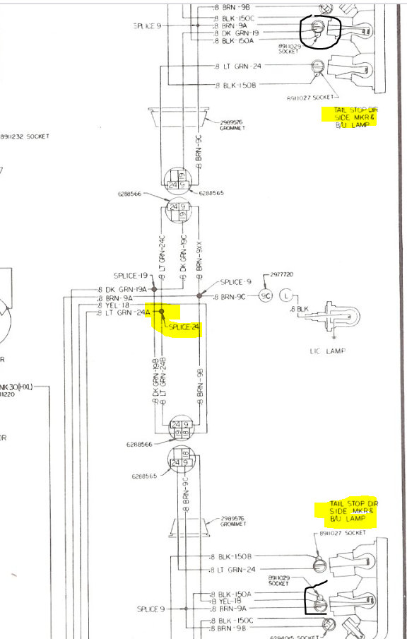

i had to screenshot the upper and lower halves of this diagram as "prodemand" would not let me copy it
looks like black is the ground (the right side of either diagram is the brake/ tail lights)
as a test, you might run a temporary jumper wire from ground, to the black wire to provide it with a "for sure" ground, till you can find the "open" on the original circuit. it may even look grounded, loosen the anchor and scooch it around or clean the area.
you should be able to see where diagram one overlaps diagram two
the medic

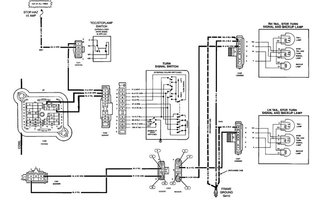

The brake lites are wired through the turn signal switch. When you step on the brake, yellow wire carries voltage for left brake lite. When you activate the brake switch, if the yellow wire coming from the steering column, isn't hot, I suspect the turn signal switch. If you get at the switch, you can check feed to and from before you remove.
