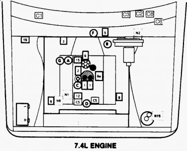

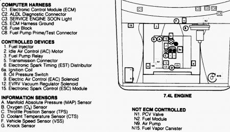

Fuel Pump Oil Pressure Switch (Back-Up Circuit) To test fuel pump oil pressure switch back-up circuit, start engine. With engine running, disconnect fuel pump relay. If engine stalls, fuel pump oil pressure switch is faulty. If vehicle continues to run, switch is okay. Fuel Pump Relay See RELAYS, SOLENOIDS, MOTORS & MODULES. Fuel Pump Relay By-Pass Procedure If fuel pump will not energize, relay may be by-passed to test fuel pump. Turn ignition off. Using a fused jumper wire, apply battery voltage to fuel pump test connector. Fuel pump should turn on. For fuel pump test connector location, refer to COMPONENT LOCATIONS .
https://www.2carpros.com/forum/automotive_pictures/62217_loc_1.jpg
https://www.2carpros.com/forum/automotive_pictures/62217_loca_1.jpg
After you bypass the relay, check for power at the fuel pump connector. If I remember, it's a gray wire for power. If no power, follow the wire to the inline fuse...check that.

The Gray power wire is powered by the PCM, and is cut out by low oil pressure switch, try the test connector test that I described above, the connector should be over by the master cylinder.
Fuel Pump Relay 1. If a prolonged crank is required to start vehicle, fuel pump relay may be faulty. To verify this, start engine. With engine running, disconnect oil pressure switch (fuel pump back-up circuit). If engine stalls, fuel pump relay is faulty. If vehicle continues to run, relay is okay. Check for other causes of prolonged crank. 2. To test fuel pump relay, disconnect fuel pump relay. Refer to COMPONENT LOCATIONS. See Fig. 4. Apply battery voltage and ground to fuel pump relay winding terminals. To identify fuel pump relay terminals, see appropriate WIRING DIAGRAMS article in this section. 3. Using an ohmmeter, check continuity between fuel pump relay power and fuel pump relay drive terminals. Continuity should exist. If continuity does not exist, fuel pump relay is defective. 4. To by-pass fuel pump relay on vehicle (fuel pump not operating), turn ignition off. Disconnect fuel pump relay connector. Using a fused jumper wire, connect fuel pump test connector to positive side of battery. Fuel pump should run. 5. If fuel pump runs, check for faulty connections to relay or replace defective relay. To locate fuel pump test connector, refer to COMPONENT LOCATIONS.

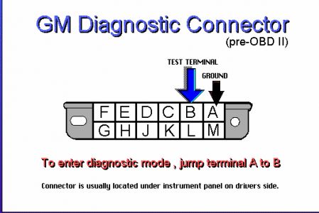

Sorry, I didnt get a chance to even turn on my computer Monday, overtime at real job! Will look into the tranny issue today...In the mean time, lets read the codes, by now it must have set at least one!Cross these two terminals as shown with a piece of wire, then turn the key on. Count the flashes, a 22 will flash as 2 flashes then a short pause, then 2 flashes, if more than one code is stored, the pause will be longer. The codes will display three times and end with 12. Write them down and post here. This connector is right under the middle of the dash...
