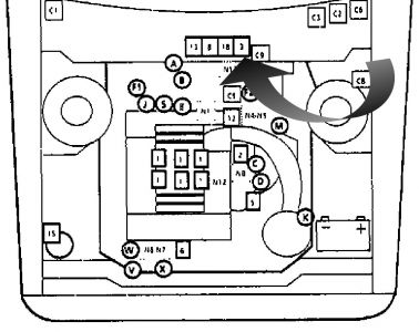

I am looking for the relay switch for the fuel pump that is is the gas tank. It has a 3.1 engine in it, and me being female it has me stumped please help me.

There are two fuse boxes. One in the passenger compartment the other under the hood. The under the hood box normally houses the relays.

http://www.2carpros.com/forum/automotive_pictures/30961_relay_2.jpg
The #3 is the fuel pump relay.
