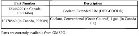

Important: The following procedure recommends refilling the system with DEX-COOL(R) P/N 12346290 (in Canada, use P/N 10953464), GM specification 6277M. This coolant is orange in color and has a service interval of 5 years or 240,000 km (150,000 mi). However, when used on vehicles built prior to the introduction of DEX-COOL(R), maintenance intervals will remain the same as specified in the Owner's Manual.
If available, use the approved cooling system flush and fill machine (available through the GM Dealer Equipment Program) following the manufacturer's operating instructions.
If approved cooling system flush and fill machine is not available, drain the coolant and dispose of properly following the draining procedures in the appropriate Service Manual. Refill the system using clear, drinkable water and run the vehicle until the thermostat opens. Repeat and run the vehicle three (3) times to totally remove the old coolant or until the drained coolant is almost clear. Once the system is completely flushed, refill the cooling system to a 50%-60% concentration with DEX-COOL(R), P/N 12346290 (in Canada, use P/N 10953464), GM specification 6277M, following the refill procedures in the appropriate Service Manual. If a Service Manual is not available, fill half the capacity of the system with 100% DEX-COOL(R), P/N 12346290 (in Canada, use P/N 10953464), GM specification 6277M. Then slowly add clear, drinkable water (preferably distilled) to the system until the level of the coolant mixture has reached the base of the radiator neck. Wait two (2) minutes and reverify the coolant level. If necessary, add clean water to restore the coolant to the appropriate level.
Once the system is refilled, reverify the coolant concentration using a Refractometer J 23688 (Fahrenheit scale) or J 26568 (centigrade scale) coolant tester, or equivalent. The concentration levels should be between 50% and 65%.
Flushing Procedure using Conventional Silicated (Green Colored) Coolent
Important: 2004-2005 Chevrolet Aveo (Pontiac Wave, Canada Only) does not use DEX-COOL(R). The Aveo and Wave are filled with conventional, silicated engine coolant that is blue in color. Silicated coolants are typically green in color and are required to be drained, flushed and refilled every 30,000 miles (48,000 km). The Aveo and Wave are to be serviced with conventional, silicated coolant. Use P/N 12378560 (1 gal) (in Canada, use P/N 993089 (4L). Refer to the Owner's Manual or Service Information (SI) for further information on OEM coolant.
Important: Do not mix the OEM orange colored DEX-COOL(R) coolant with green colored coolant when adding coolant to the system or when servicing the vehicle's cooling system. Mixing the orange and green colored coolants will produce a brown coolant which may be a customer dissatisfier and will not extend the service interval to that of DEX-COOL(R). Conventional silicated coolants offered by GM Service and Parts Operations are green in color.
If approved cooling systems flush and fill machine is not available, drain coolant and dispose of properly following the draining procedures in appropriate Service Manual. Refill the system using clear, drinkable water and run vehicle until thermostat opens. Repeat and run vehicle three (3) times to totally remove old coolant or until drained coolant is almost clear. Once the system is completely flushed, refill the cooling system to a 50%-60% concentration with a good quality ethylene glycol base engine coolant, GM P/N 12378560, 1 gal (in Canada, use P/N 993089 4L), conforming to GM specification 1825M, or recycled coolant conforming to GM specification 1825M, following the refill procedures in the appropriate Service Manual. If a Service Manual is not available, fill half the capacity of the system with 100% good quality ethylene glycol base (green colored) engine coolant, GM P/N 12378560 1 gal., (in Canada, use P/N 993089 1L) conforming to GM specification 1825M. Then slowly add clear, drinkable water (preferably distilled) to system until the level of the coolant mixture has reached the base of the radiator neck. Wait two (2) minutes and recheck coolant level. If necessary, add clean water to restore coolant to the appropriate level.
Once the system is refilled, recheck the coolant concentration using a Refractometer J 23688 (Fahrenheit scale) or J 26568 (centigrade scale) coolant tester, or equivalent. Concentration levels should be between 50% and 65%.

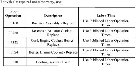

https://www.2carpros.com/forum/automotive_pictures/248015_1_135.jpg

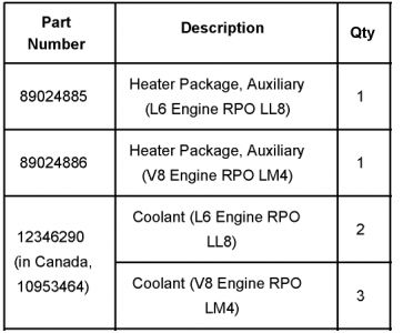

Correction
Install auxiliary heater pump package, P/N 89024885 (L6 Engine RPO LL8) or P/N 89024886 (V8 Engine RPO LM4 or LH6). This pump will improve coolant flow to the rear heater core. Use the procedure listed below.

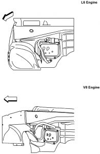

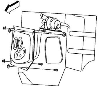

27. Remove the four nuts and the HVAC plate from the dash panel.

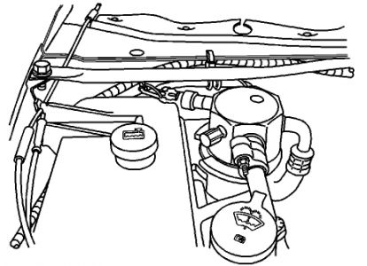

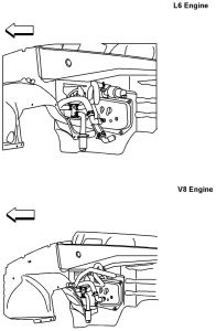

https://www.2carpros.com/forum/automotive_pictures/248015_3_61.jpg
https://www.2carpros.com/forum/automotive_pictures/248015_4_38.jpg

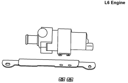

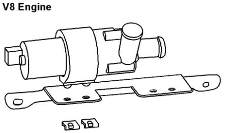

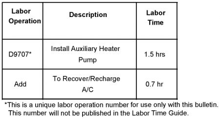

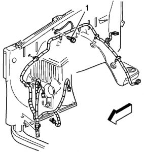

28. Attach the new auxiliary heater pump to the new bracket using the supplied retainers as shown. Note the position of the pump on the bracket.
https://www.2carpros.com/forum/automotive_pictures/248015_5_25.jpg
29. Install the auxiliary heater pump and bracket onto the dash panel studs.
30. Reinstall the HVAC plate and nuts.

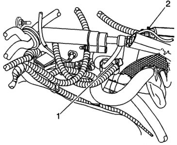

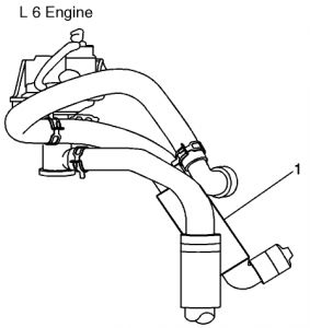

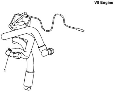

31. On the coolant bypass valve, remove the hose (1) that went from the valve to the engine and discard.
https://www.2carpros.com/forum/automotive_pictures/248015_8_7.jpg
https://www.2carpros.com/forum/automotive_pictures/248015_9_6.jpg
32. Install the new hose (1), # 1005 (L6 engine) or# 1006 (V8 engine) onto the coolant bypass valve at the location the above hose was removed. The other end of this hose will be installed on the auxiliary heater pump outlet port.
https://www.2carpros.com/forum/automotive_pictures/248015_10_5.jpg
33. Install the new hose, # 1003 (L6 engine) or # 1004 (V8 engine) onto the auxiliary heater pump inlet port. Connect the other quick connect end to the engine.
https://www.2carpros.com/forum/automotive_pictures/248015_11_4.jpg

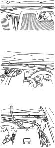

40. Install the new auxiliary heater pump wiring harness to the vehicle.

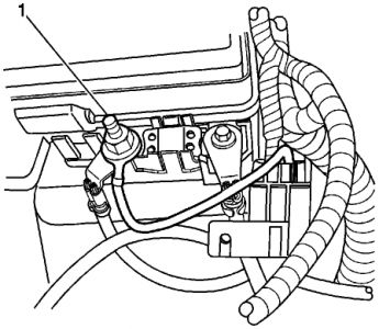

https://www.2carpros.com/forum/automotive_pictures/248015_12_4.jpg
40.1. Install the ring terminal (black wire) to ground G103 (1), located on the right side inner tender.
40.2. Route the pump wiring harness along the existing right side forward lamp harness.
https://www.2carpros.com/forum/automotive_pictures/248015_13_2.jpg
40.3. Connect the electrical connectors to the coolant bypass valve (1) and auxiliary heater pump (2).
https://www.2carpros.com/forum/automotive_pictures/248015_14_2.jpg
40.4. Position the relays onto the inner wheelhouse panel near the rear of the engine compartment.
https://www.2carpros.com/forum/automotive_pictures/248015_15_2.jpg
40.5. Route the other end of the harness along the rear of the engine compartment to the left side and secure to the cross bar and dash panel with tie straps.
https://www.2carpros.com/forum/automotive_pictures/248015_16_1.jpg

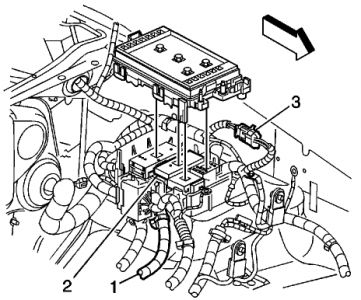

40.6. Install the ring terminal (orange wire) to the underhood fuse block stud (1).
https://www.2carpros.com/forum/automotive_pictures/248015_17_1.jpg
40.7. Locate circuit no. 241 or 441 (ignition 3 brown wire) (PIN B11 or C11) in the existing underhood fuse block harness (1) of C2 (2) and splice bare wire to it using a splice clip. Wrap with electrical tape.
40.8. Locate connector C105 (3), located on the left side inner fender. Separate the connector halves. On the female side of the connector, remove the terminal from cavity F (gray/black wire) and tape back.
40.9. Install the terminal end on the pump wiring harness into cavity F of connector C105.

Hello -
You are more than welcome on the help/info.................
To me......... And again......... This is just my thought....... If it were me I would replace it. It looks like it runs about $77 at Auto Zone and I show two part numbers from Chevy... A 15-63083 and 8902339 both for about $148 beans.......
From what I see once you get the panels off it is easy access..... Compared to the front core that you have to take the dash apart.........I may be wrong but that is what my manual shows.....
Next, a back flush by you....... You could instantly see good flow.....A radiator shop... Would probably use a chemical........... But to me...I just haven't had really good luck on back flushing...........I replace......... The ports... Or core holes are pretty small and you can actually take a infrared thermometer and go across a radiator and it will show hot and cool spots......... Thus you will have flow but some areas are blocked.........
It sat for a while......... Had about 15K put on it......... Your in-laws (I think you said) have had it for a year or more to get up to about 40K......... That is now about 4 years....... To me the cost of replacement will be almost as much as the flush and you are sure to have a good clean clear one if replaced............. So to me.........I would just replace....... It may even be cheaper than the flush...............
What are your thoughts?
Oh, if you are still running the Dex-cool I would flush that out and go with the green Prestone. You can purchase a flush kit at AutoZone by Prestone, it has a T-Fitting you plug right into your heater hose..... Hook the water hose to it, crank the engine and remove the radiator cap and away it goes............. This flushes the engine also......... Gets it all out.......
Then you drain..... And refill 50/50 with the green Prestone.
If it were me...........I would do the complete flush............. Drain....... Replace the rear core......... Fill/bleed and see how it does.......
I totally agree with you........... First get the heater going and then check on the aux pump... If may run you out of the back the way it is.........
Let me know what you think.............
Oh, did you have time to check on the recalls......... Did any apply?
Thanks and have a great day.
