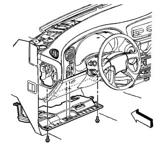

Instrument Panel Insulator Panel Replacement - Left Side
Removal Procedure
https://www.2carpros.com/forum/automotive_pictures/309872_712800_1.jpg
Remove the 2 screws that retain the insulator panel to the instrument panel (I/P).
Release the insulator panel retaining clip from the I/P substrate.
Lower the insulator panel.
Remove the 2 data link connector (DLC) retaining screws.
Remove the DLC from the insulator panel.
Remove the splice pack from the insulator panel.
Remove the hazard and turn signal flasher from the insulator panel. Refer to Hazard and Turn Signal Flasher Replacement .
Remove the insulator panel from the I/P.

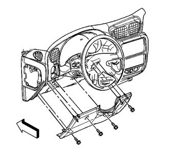

Driver Knee Bolster Panel Replacement
Removal Procedure
Remove the left closeout/insulator panel. Refer to Instrument Panel Insulator Panel Replacement - Left Side .
https://www.2carpros.com/forum/automotive_pictures/309872_712827_1.jpg
Remove the 4 trim panel retaining screws.
Release the clips that retain the trim panel to the IP.
Remove the trim panel from the IP.
