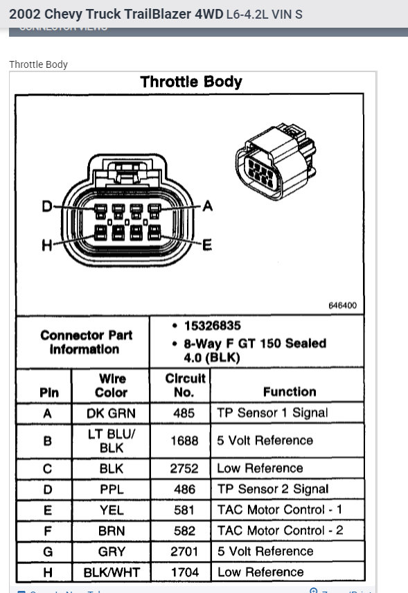

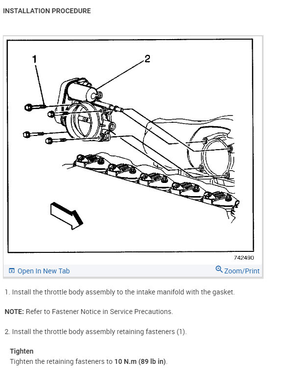

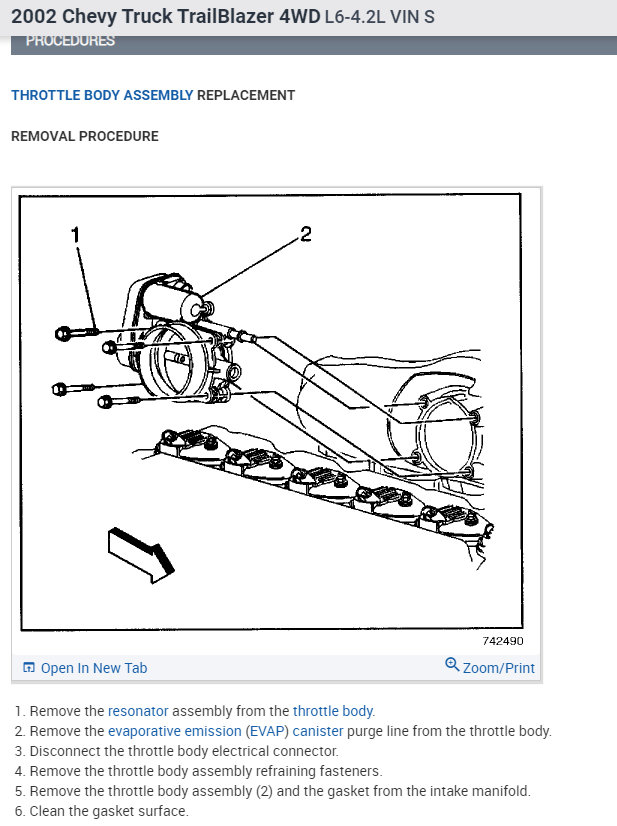

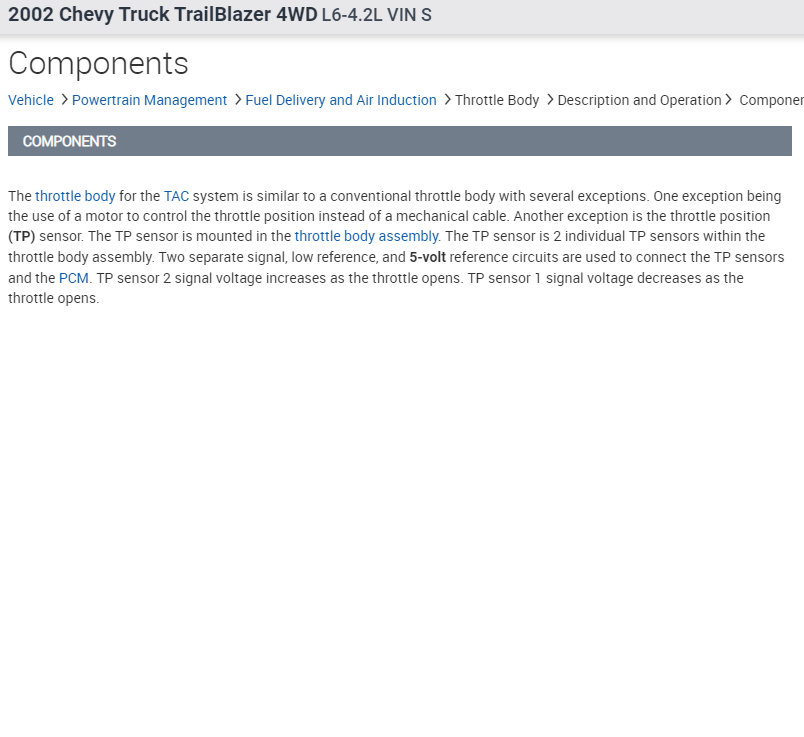

SQM
  • CAR REPAIR CONTRIBUTOR
  • 6,383 POSTS
This Trailblazer is not equipped with an idle air control valve (IAC). The IAC function gets performed by the electronic throttle actuator.
Cleaning out the throttle actuator is a good first step. As dirty actuator can trigger idling issue and won't be able to adjust according to the engine load (when the A/C gets turned on, etc.).
Here is a helpful guide on cleaning the throttle actuator:
