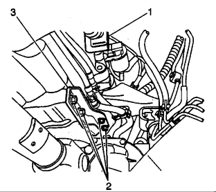

How do i drop the oil pan off a 2000 chevy tracker 2.0L 4 dr? im trying to replace the oil pan gasket but there is a piece of the frame that is right under the oil pan that cannot be removed, help me PLease!!
May 23, 2010 at 1:55 PM
  • CAR REPAIR CONTRIBUTOR
  • 75,992 POSTS
Removal Procedure 1.Remove the oil level indicator. 2.Raise and support the vehicle. Refer to Vehicle Lifting. 3.Remove the front skid plate from the vehicle (if equipped). 4.Remove the front axle assembly from the chassis (4WD only). Refer to Front Axle Housing Replacement. 5.Remove the steering gear. Refer to Power Steering Gear Replacement. 6.Drain the engine oil.

7.Remove the 4 bolts and the right side engine block-to-transmission support bracket (3). 8.Remove the flywheel cover.

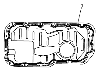

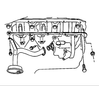

9.Remove the 16 bolts and the 2 nuts from the lower cylinder block: Notice: Do not damage the oil pan contact surface of the lower cylinder block when removing the oil pan. 10.Carefully remove the engine oil pan. 11.Remove the 3 bolts and the oil pump strainer. 12.Clean the following components: **The inside of the engine oil pan **The oil pump strainer screen **The mating surfaces of the engine oil pan and the lower cylinder block Installation Procedure 1.Install new O-rings and install the oil pump strainer to the oil pump. Notice: Refer to Fastener Notice in Service Precautions. 2.Install and tighten the 2 strainer bolts first and then the bracket bolt. **Tighten the 3 bolts to 11 Nm (97 inch lbs.).
