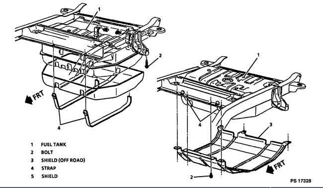

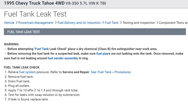

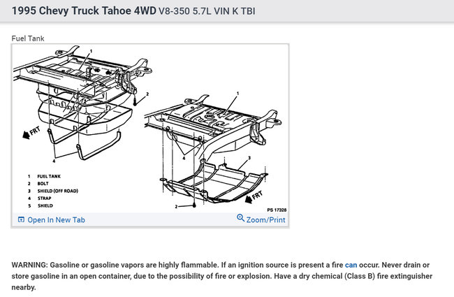

JOSH RABER
I have all new fuel pump and lines on the Tahoe all ready. so I don't think that's what's leaking. I cleaned the tank and the dripping starts at the bottom so I guess my tank might be cracked?
Jun 2, 2021 at 2:41 PM (Merged)
SCGRANTURISMO
  • CAR REPAIR CONTRIBUTOR
  • 4,897 POSTS

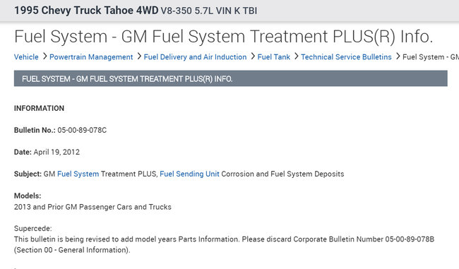

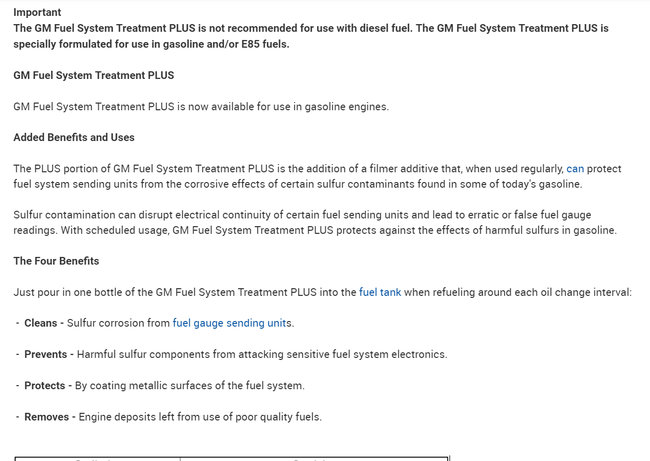

Hello again,
Yes. If the dripping is coming from the bottom than I would say that yes, the fuel tank is compromised. But to be absolutely sure, I have included instructions on removal and installation of the fuel tank, testing the fuel tank for leaks, and Technical Service Bulletin (TSB) from GM that you may or may not be interested in, down below in the diagrams. Please go through this information and get back to us with what you find out.
