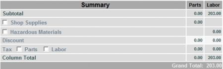

BLUELIGHTNIN6
  • 16,542 POSTS
Approx. $200 in labor only for replacing both rear wheel bearings.

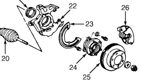

MERLIN2021
  • 17,250 POSTS
Remove the axle nut with truck on the ground, then jack up that side, remove caliper, slide off the rotor, on the hub will be a hole you line up on a bolt head, insert the socket, remove bolts(3), unplug ABS sensor wire, pull hub bearing out. You may need to tap it with a hammer.

MERLIN2021
  • 17,250 POSTS
That info is for 2 wheel drive.
