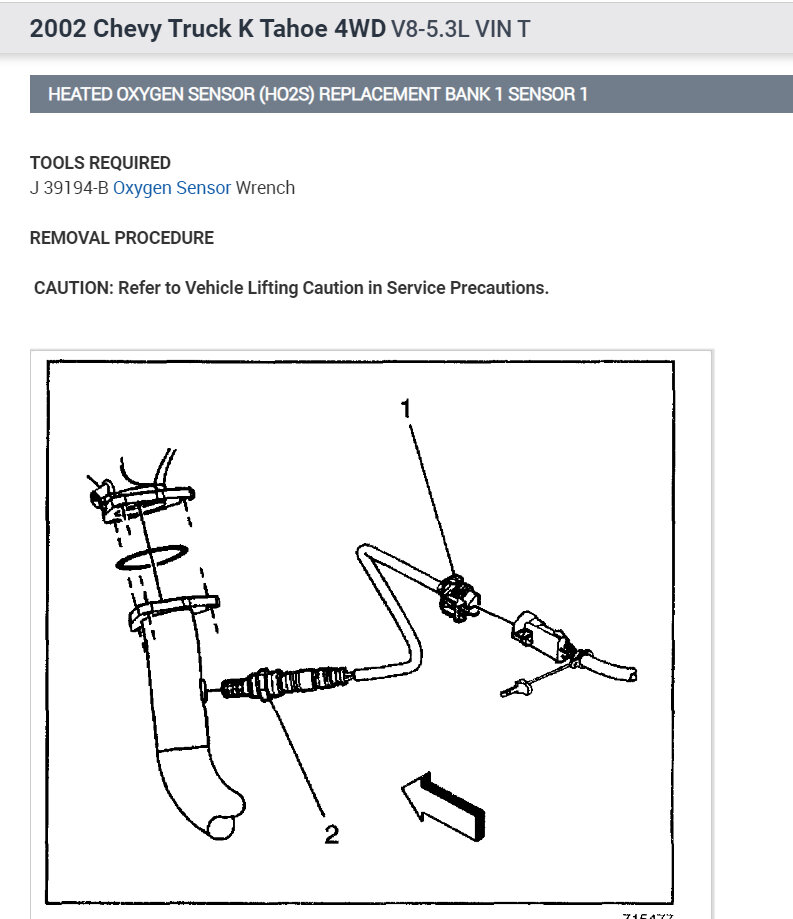

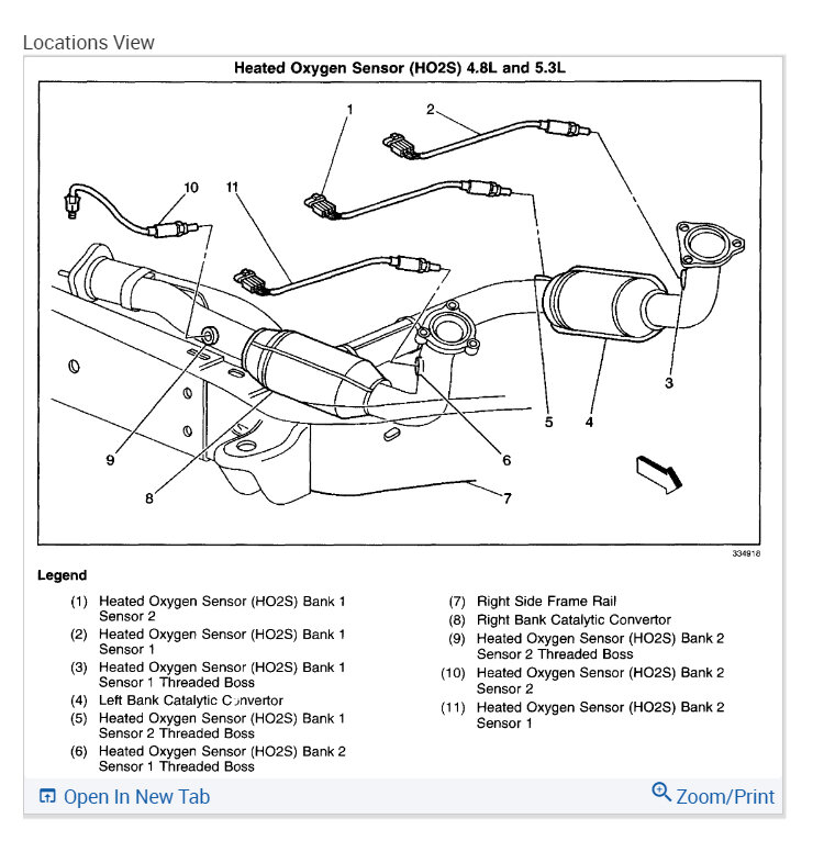

I was wondering how to change the bank one O2 sensor in my truck. I don't know which one of the oxygen sensors would be bank one, sensor one. Thank You.
Feb 14, 2008 at 10:24 AM
BLACKOP555
  • 10,386 POSTS

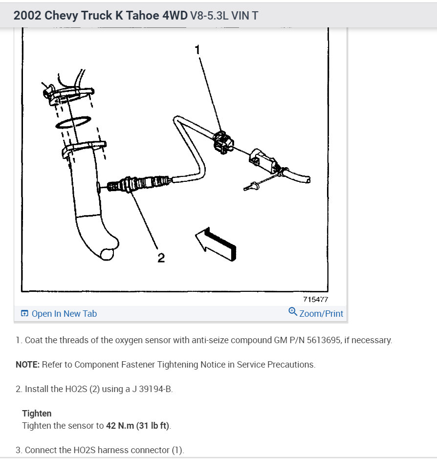

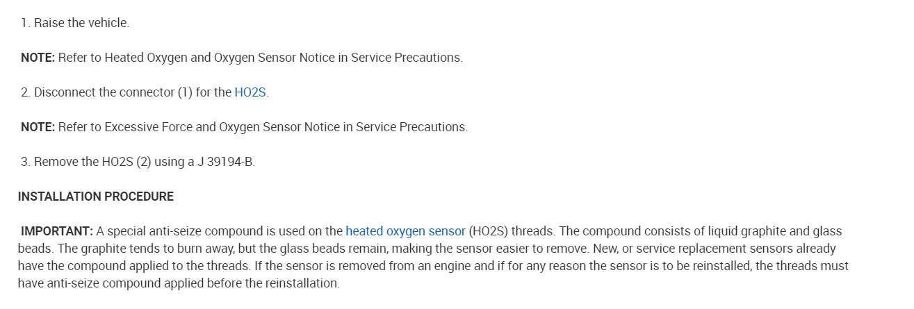

There is a special socket sold at auto part stores to remove them, bank 1 is the side of the engine with the #1cylinder/spark plug. sensor one is the one before the catalytic converter. Here is a guide to help walk you through and the location is the images below.
https://www.2carpros.com/articles/how-to-replace-an-oxygen-sensor
Check out the images (Below). Please let us know what happens.
