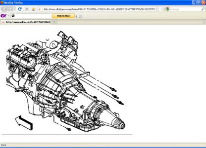

As a young, aspiring "mechanic", i've removed three transmissions so far. The first two were on older vehicles and had 6 bolts/studs that mounted the trans to the engine. The Chiltons Manual for the 99 tahoe says there are nine nuts/bolts to remove in order to pull the trans. As far as i can see and feel, i can only find 8...does anyone know if there are only 8 bolts or am i missing the ninth one somewhere?

https://images.2carpros.com/forum/automotive_pictures/416332_1999_chevy_tahoe_transmission_bolts_1.jpg
Look's like 7 holding it in 6 stud's and one bolt.

Louie, I appreciate the response but I see a few differences right away...on the the trans i'm pulling, there's two threaded rods going through the bottom of the bellhousing with nuts holding the trans in place. I didn't remove any bolts at all, only the studs on the sides of the bellhousing. Apparently, there's three more studs on top of the trans, but i can only find two.

Give me the 8th digit of the vin Also do you know what trans you have there was 3 differt trans if I remember correctly.
