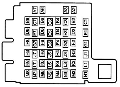

bright lights quit. Changed the dimmer switch no fix. What else could cause this?
Tuesday, November 11th, 2008 AT 6:31 AM
IMPALASS
MECHANIC
3,112 POSTS
Hello

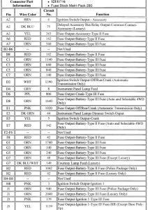

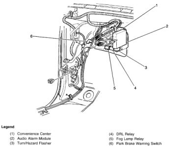

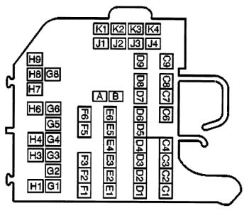

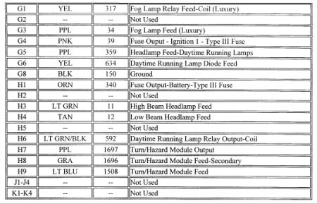

Check fuse H3 in the convenience center and fuse F8 at the IP. Make sure you use an ohm meter or a brand new fuse to check.
convenience center
IP Area
