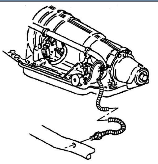

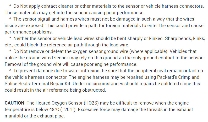

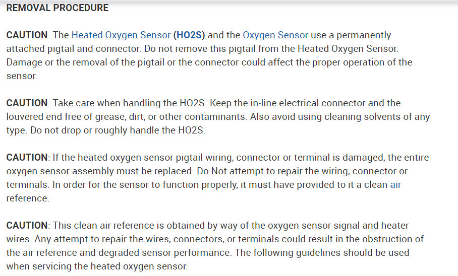

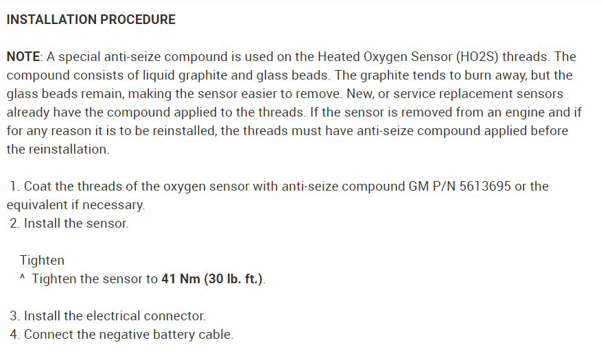

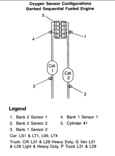

Where are the oxygen sensors located?
Thursday, February 4th, 2010 AT 10:44 AM
DANNY L
MECHANIC
5,648 POSTS
Hello, I'm Danny.

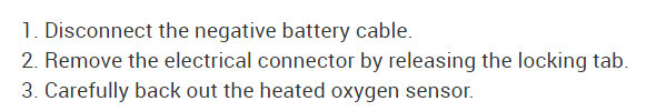

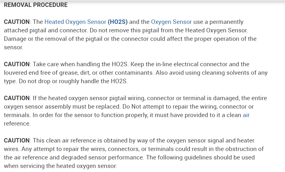

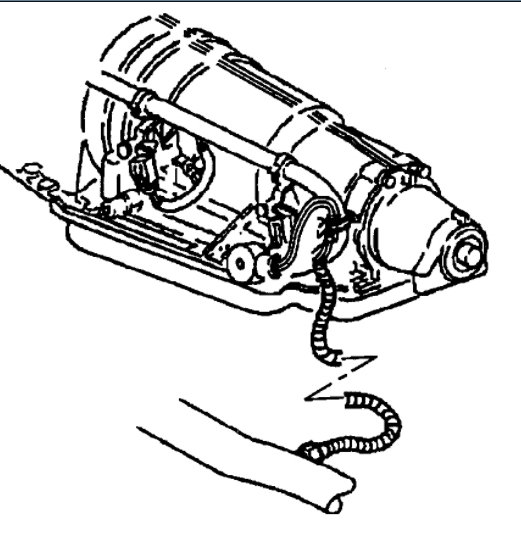

I've attached below the information you requested. The picture steps below are for the replacement of the oxygen sensors on your vehicle and include the location. Hope this helps and thanks for using 2CarPros.
