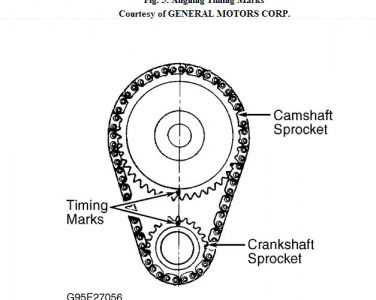

1996 Chevy Tahoe
ok so how do you reset the timing chain on a tahoe??
Sep 23, 2010 at 7:48 PM
HMAC300
  • CAR REPAIR CONTRIBUTOR
  • 48,601 POSTS
if your timing chain has jumped then you replace the chain and gears. torque the nuts to 18 foot lbs on reinstallation. here is pic of what you should set it up to.
