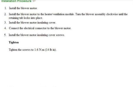

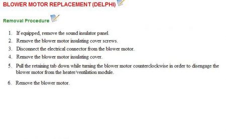

How do I replace the blower motor in my 2003 Suburban?
Wednesday, July 29th, 2009 AT 11:54 AM
BLUELIGHTNIN6
MECHANIC
16,542 POSTS
+1
Wednesday, July 29th, 2009 AT 3:19 PM
