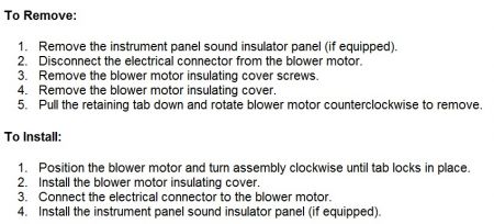

HOW DO YOU REPLACE THE BLOWER MOTOR ON A 02 SUBURBAN

I looked at info for sub 1500, delphi blower motor. Should be located under passenger side dash.
