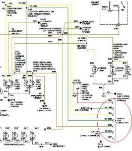

Im trying to wire a trailer harness on my 99 suburban but i cant find the right wires to tap into. there is a dark green and a light green, yellow, brownish colored one and a blaclk one by itself what ones do i use.

Below is diagram for wires for trailer harness. If you can not resize the image to better see words, I also have the colors and associated circuits posted below diagram.
https://images.2carpros.com/forum/automotive_pictures/261618_Noname_35.jpg
RED - UNDER-HOOD FUSE/RELAY CENTER (HOT AT ALL TIMES) LIGHT GREEN - BACK-UP LIGHTS CIRCUIT YELLOW - TAIL/STOPLAMP HARNESS, 7CM FROM G415 DARK GREEN - TAIL/STOPLAMP HARNESS, 7CM FROM TRAILER HARNESS BREAKOUT BROWN - REAR LAMPS HARNESS, 27 CM FROM TRAILER HARNESS BREAKOUT (W/ DUEL REAR WHEELS) DARK BLUE - AUXILIARY LEAD (TAPED TO HARNESS) WHITE - G415
