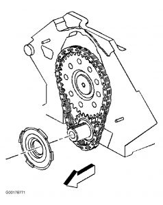

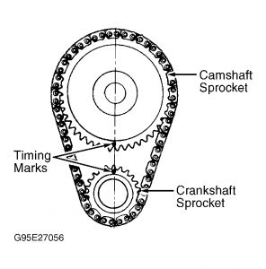

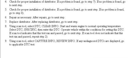

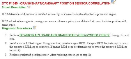

Im looking for the proper prociture to put my truck in the right ignition timing, my truck is of timing, has a code of P1345

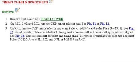

Your ignition timing is controlled by the ECM. Just make sure that your timing marks are correct.
https://www.2carpros.com/forum/automotive_pictures/55316_98tahoetiming_1.jpg
Figure 12
https://www.2carpros.com/forum/automotive_pictures/55316_98tahoefig12_1.jpg
Figure 14
https://www.2carpros.com/forum/automotive_pictures/55316_98tahoefig14_1.jpg
