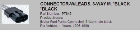

We put 4-5 fuel pumps in before we gave up. The truck has been sitting for about a year. I started reading posts about bad wiring harnesses in these Suburbans so I decided to roll under the truck to see if there was anything I could locate & visually find as a problem.
I found a 3 wire connentor coming out of the tank of which 1 of the wires was broken.
Did this thing seriously sit for this long & there's only a broken wire ??? Yes it did !!!
But the wire is broken about 1/4 inch off the connector so there's not much wire to work with & re-connect.
I did manage to do it but it just seems like a matter of time before it comes apart again.
Does anyone know where I can get a new connector ? What its technical name is ?
If I find this mystery connector, can I just replace the "bad" half thats outside of the tank or is that a really bad idea ?
Thank you

Welcome to the forum, found this at acdelco
https://images.2carpros.com/forum/automotive_pictures/170934_fuel_pump_connector_1.jpg
not sure if that is what you want?
Nov 12, 2009 at 12:27 PM
TILICKE21
This looks exactly like what I need !!!
Thank you
