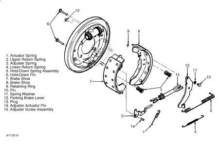

1996 Chevy Suburban rear break assamly drawing
1996 CHEVROLET SUBURBAN
150,000 MILES • V8 • 4WD • AUTOMATIC
SHDJENN2671
Do you have 1996 suburban rear break draing for repair reference? I took the rear break both side apart. When I put them back, there is a 1 inch long and 1/2 inch diameter spring left out. I do not know where it goes, can you help?
Aug 15, 2009 at 9:49 PM
MHPAUTOS
  • CAR REPAIR CONTRIBUTOR
  • 31,937 POSTS
Hi there, I hope that this pic is what you need, if not let me know and i will look further. Mark (mhpautos)
