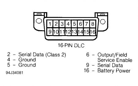

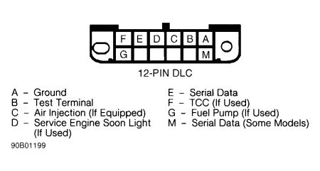

When I crank the car the airbag light flashes, then goes out so I want to find the code, to find the fault in the unit.
Thursday, October 21st, 2010 AT 9:53 AM
DOCFIXIT
MECHANIC
18,828 POSTS
Hi
If SIR is operating properly light will flash 7-9 times on start up. Need a scanner to read SIR codes. Can access PCM codes 12 pin jumper from A-B
16 pin jumper from pin 5-6
Hope this helps
