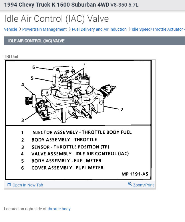

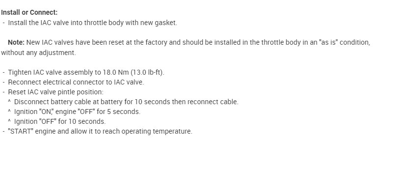

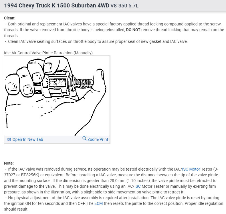

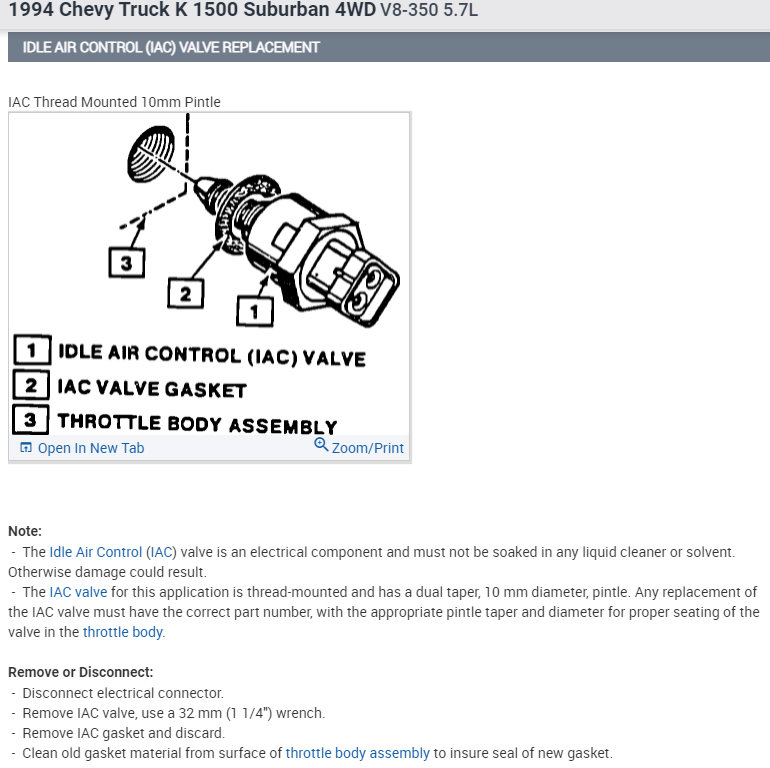

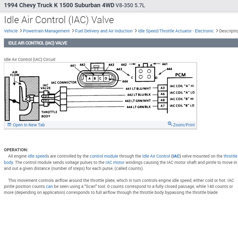

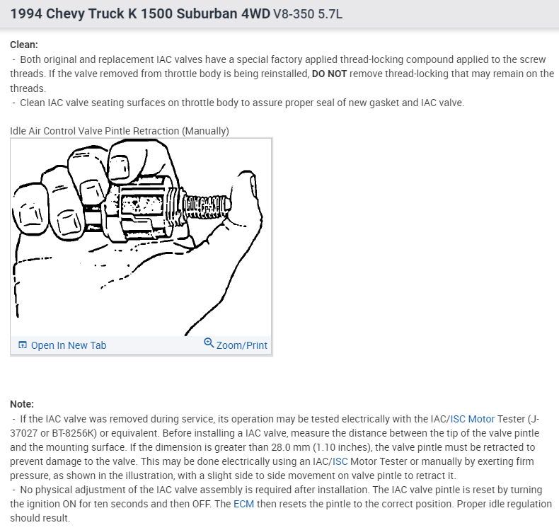

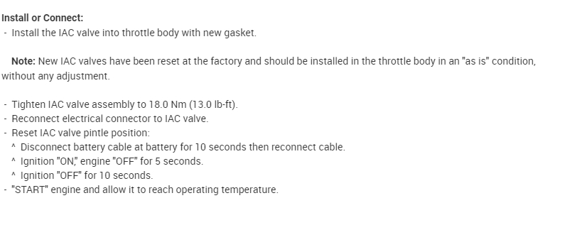

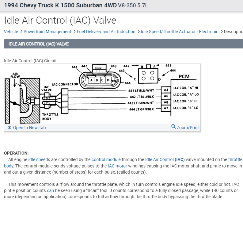

It sounds like an issue with the idle air control valve (IAC).
A faulty or dirty IAC can impact the way the engine idles.
The spring inside of the IAC can become weak and allow more air to pass thru and create a high idle. It can also make it run rough.
Here is a helpful guide:
https://www.2carpros.com/articles/engine-idles-too-high
The IAC can be serviced by cleaning it out. This can improve the quality of the idle.
https://www.2carpros.com/articles/idle-air-control-valve-service
