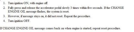

The change oil light has come on and I can't get it off. What do I do? The oil has already been changed and is fine.

If first way does not work after few attempts, try the same steps except turn the key to ACCESSORY instead of ON.
