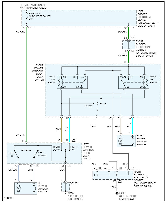

Driver side window is down. It will only go up an inch or so, then it stops.

So, I would check the circuit breaker because they can get weak and cut power to the system. Here is a guide to help check for power and the window wiring diagrams so you can see which wires to test for power to confirm the circuit breaker is the problem.
Check out the images (below). Please let us know what you find.

I replaced a broken dark green wire and now I get a clicking noise I the master switch when rolling up driver window. Took left harness entirely and the passenger window still works? Is that correct?

That is correct, the drivers window is by itself in the wiring harness.
