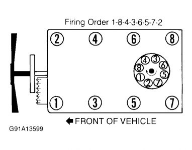

I changed my plugs and now it runs rough and I smell a sulfur smell

Where replacement plugs the correct ones? also see if cylinder 5 and 7 wires got crossed.
