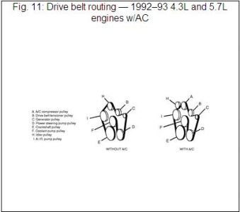

I am having trouble putting back the motor belt. Do you have a diagram to show me how to put it back on?

I wasn't sure about the litre size of your engine, if the picture isn't readable, I'll try to make larger.
