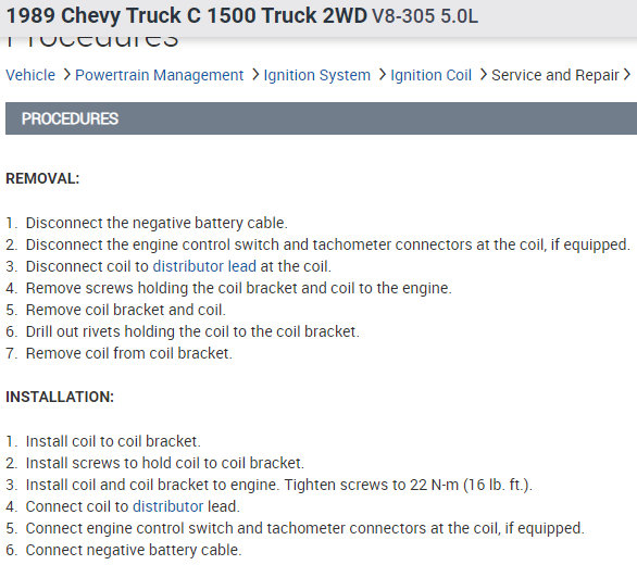

It will turn over, it's getting gas to throttle body, but it wont start. I believe it may need a coil pack, but not sure.
Thursday, January 28th, 2010 AT 2:06 PM
SQM
MECHANIC
6,383 POSTS

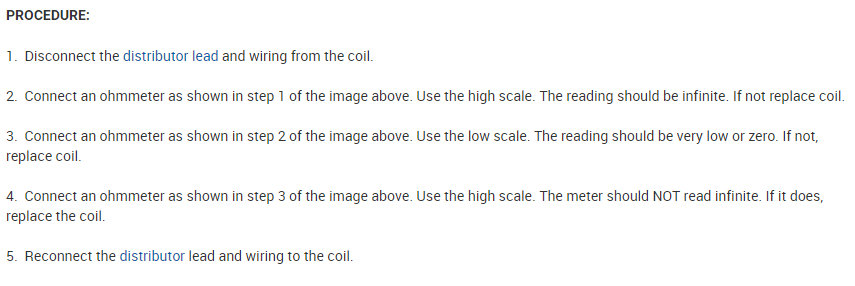

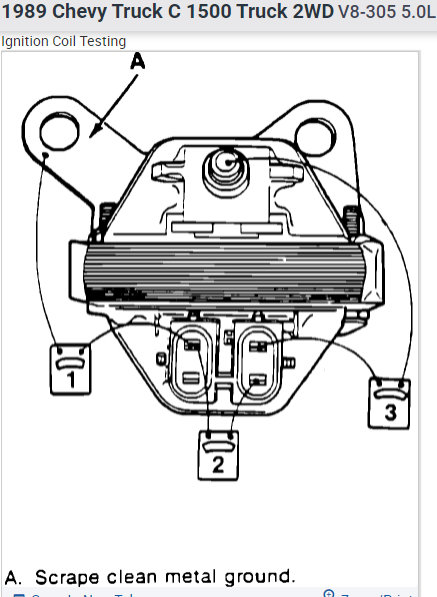

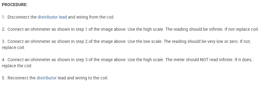

Did you check to see if you are getting spark to the plugs?
This will tell you if there might be an issue with the coil:
https://www.2carpros.com/articles/how-to-tune-up-a-car-engine
I have attached testing and replacement procedures for the coil pack.
Any questions please let me know.
