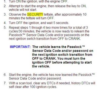

I bought the s-10 a couple of months ago was told it needed a fuel pump so i replaced the pump and now it will run for a couple of seconds and then it just quits i suspect it may have somthing to do with the security system the security light on the instrument panel occasionally flashes 3 slow flashes followed by 2 fast flashes i live in corona ca. I would greatly appriciate any advice on what to try or a place local to fix this thanks

Hi, here is a security relearn procedure you can try. Don't know if it will help?
https://images.2carpros.com/forum/automotive_pictures/170934_security_relearn_1.jpg
