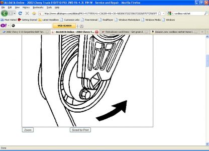

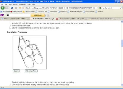

How do I get the tension off the belt to change the belt?
Sunday, August 22nd, 2010 AT 6:04 PM
SATURNTECH9
MECHANIC
30,869 POSTS
There you go.
