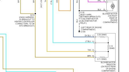

The blower works only on high (4) and max.
1, 2, 3 do not work.

Find blower motor resistor at right rear of engine compartment, sorry no pic
