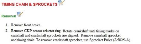

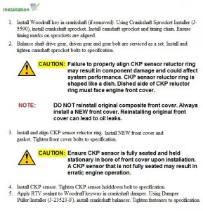

1997 Chevy S-10 timing chain
ROBERTYOST
MEMBER
1997 CHEVROLET S-10
Engine Performance problem
1997 Chevy S-10 6 cyl Four Wheel Drive Automatic
how do you change a timing chain
Tuesday, June 8th, 2010 AT 7:01 AM
BLUELIGHTNIN6
MECHANIC
16,542 POSTS
Tuesday, June 8th, 2010 AT 4:42 PM
