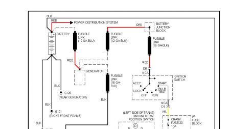

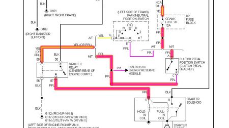

My truck starter will not even click I have gone through and replaced the starter relay, replaced the ballast resistor, replaced the clutch neutral safety switch, I have power to the starter I have power when I turn ignition switch to start all the way up to the the ballast there is no power going through the fuse, there is one wire that is hot running up to the clutch safety switch, from what I have checked all my wires seem in good shape I have checked all of my grounds in the starting system, I get full power instrument panel and radio and all other systems.

It sounds like the starter had gone out but to be sure here is a guide to help confirm the issue.
Please run down this guide and report back. Below is your starting system wiring diagram
https://www.2carpros.com/forum/automotive_pictures/12900_s1_12.jpg
https://www.2carpros.com/forum/automotive_pictures/12900_s2_11.jpg
